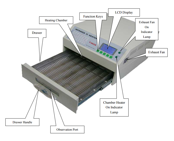

In order to fit your ESTechnical Reflow Oven Controller to T962A, SMTHouse reflow oven infrared IC Heater soldering machine, you will need some tools that are not included in the packing list. You can check the Reflow Oven Accessories Package.
Detailed steps of the installation process are listed here.
T962A Reflow Oven
T962A Reflow Oven
