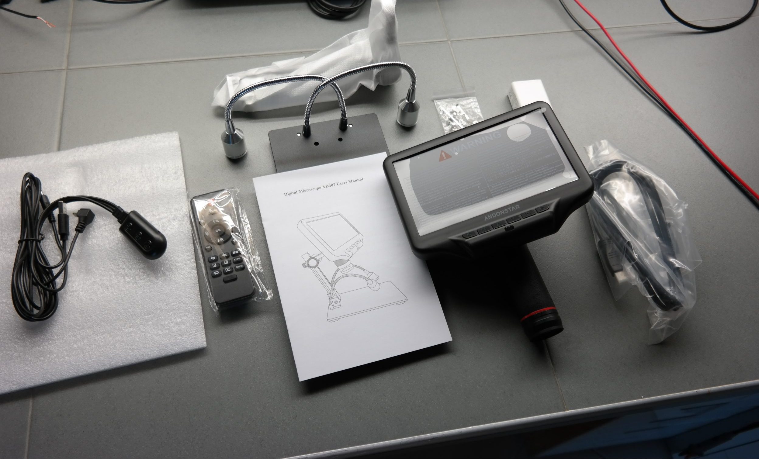

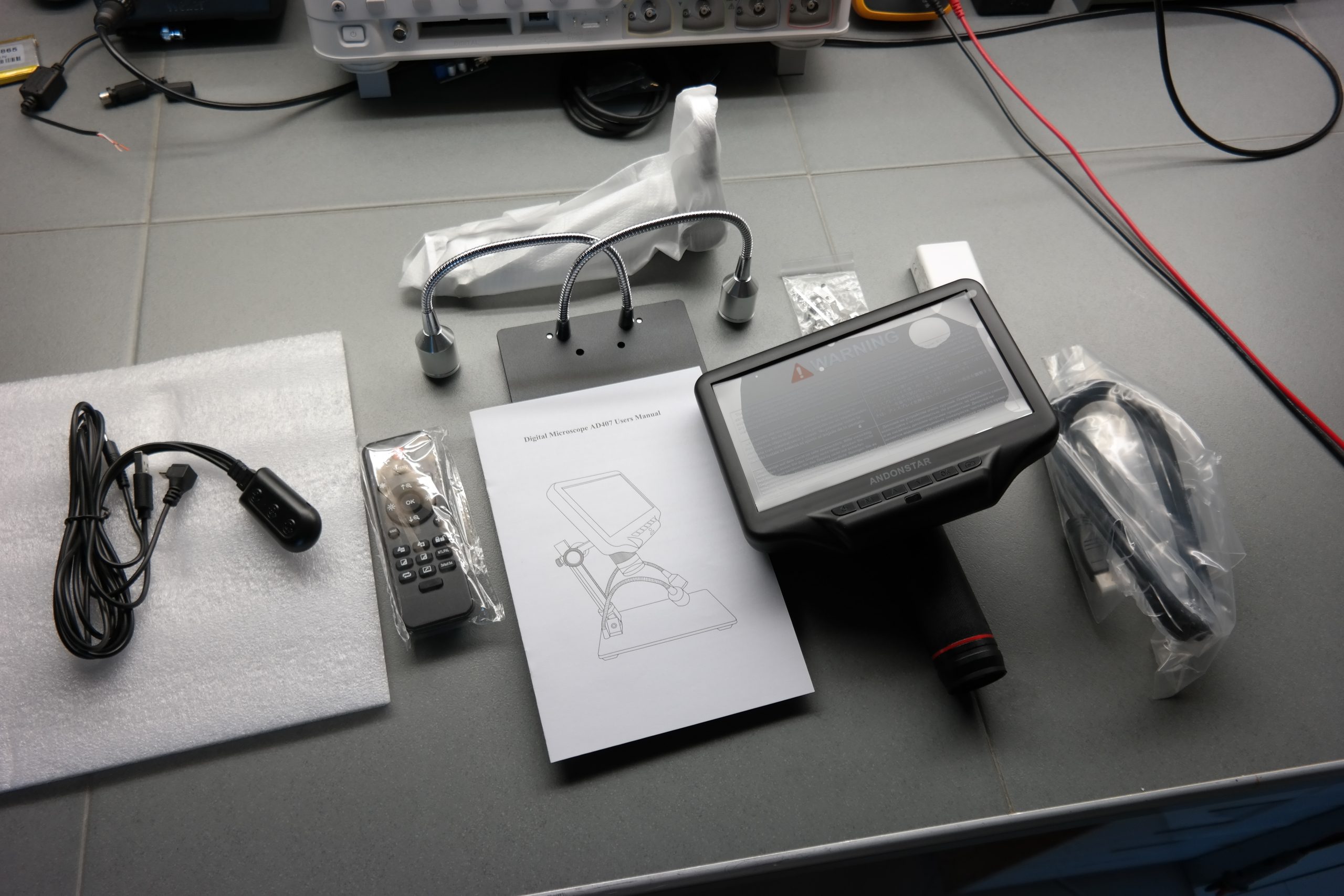

The microscope comes in a big box with plenty of insulation to protect it during transport. The box includes:
  • Microscope x1
  • Stand x1
  • HDMI cable x1
  • Switch Cable x1
  • UV Filter x1
  • IR-Remote x1(not included the battery)
  • Adapter x1
  • Users Manual x1
Unboxing and powering up the unit took only 4-5 minutes. The microscope comes assembled and all you have to do to start is to add batteries to the remote control and connect the light and power control cable the the USB adapter. Hit power ON button and you are ready to go.
