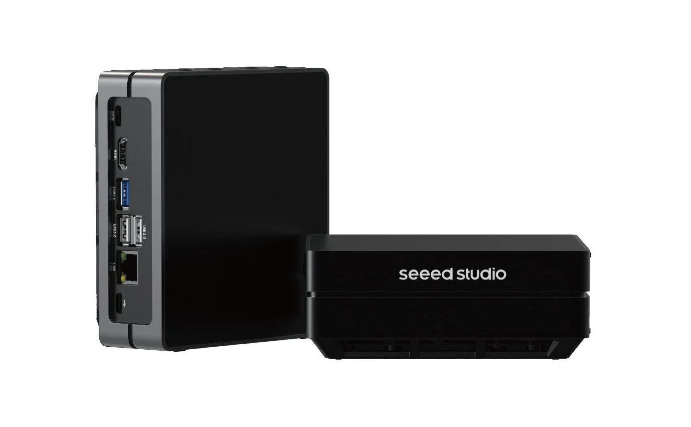

The reComputer Jetson edge computer comes in the same design as the Jetson Nano Developer’s Kit reference carrier board with a rich set of input/output ports, including a Gigabit Ethernet port, USB 3.0 and 2.0 ports, and HDMI port.

Specifications of the reComputer Jetson-10-1-A0
  • Module: NVIDIA Jetson Nano (production version)
  • CPU: Quad-core ARM A57 clocked at a frequency of 1.43 GHz
  • GPU: 128-core NVIDIA Maxwell
  • Storage: 16GB eMMC
  • Memory: 4GB 64-bit LPDDR4
  • AI performance: 472 GFLOPS
  • USB: 1x USB 3.0 Type-A Connector, 2x USB 2.0 Type-A Connector, 1x USB Type-C for device mode
  • Camera interface: 2x CSI camera MIPI CSI-2
  • Display interface: HDMI Type A
  • Power: USB Type-C for 5V input for power
  • Dimensions: 130x120x50 mm (with case)
