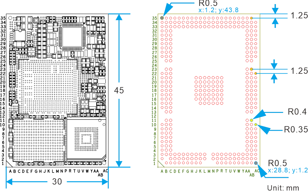

Boardcon LGA3576 SoM with Rockchip RK3576 SoC front and back
