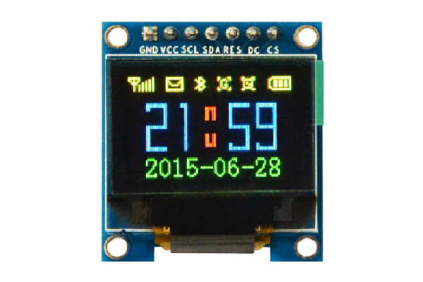

A second choice is the OLED displays. OLED is an organic light emitting diode in which the emissive electroluminescent layer is a film of organic compound that emits light in response to an electric current. An OLED display works without a backlight; it can display deep black levels and can be thinner and lighter than a liquid crystal display. Thus, it is provides better contrast than the LCD choice but it becomes a bit more expensive.
color_oled
One of the newest OLED displays is the color SSD1331 display that can display 65.000 colors. Just download its library from Adafruit and start using it. A video explaining how to use it is available here.

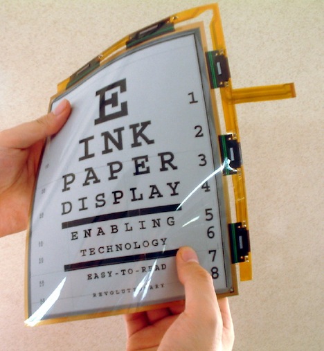

The last type is E-paper displays, that mimic the appearance of ordinary ink on paper.
lg-paper
Unlike LCD or OLED displays, these displays reflect light instead of emitting it. Such displays are great for low power projects since they have the ability to keep the text or the image you had set before for a really long time and without electricity. One of these displays disadvantages that they are absolutely costly compared with other choices, some displays can reach $60!

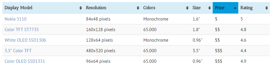

Color TFT Display ST7735, White OLED Display SSD1306 and 3.5″ Color TFT Display are all mentioned in the tutorial. You should check it out for more details, information, and some hardware offers.
The tutorial concludes with this interactive table based on different criteria, this is ordered progressively by price. You can compare between displays here.
