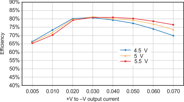

Figure 2. C biasing dominates losses in the split-rail bias circuit at lower currents,
but conversion efficiencies greater than 80% are attainable.
Resistor R10 sets the PWM’s nominal switching frequency to 600 kHz, which represents a compromise between conversion efficiency and noise (both switching noise and ripple) on the bias voltage outputs and transformer size. With this frequency, conversion efficiency (Fig. 2) can be greater than 80% depending on load. Both noise and conversion efficiency decrease with increasing switching frequency, so designers can choose to increase efficiency at the expense of noise by adjusting the value of R10. Decreasing the switching frequency often results in the need to increase the size of the transformer, adding to this tradeoff decision.
