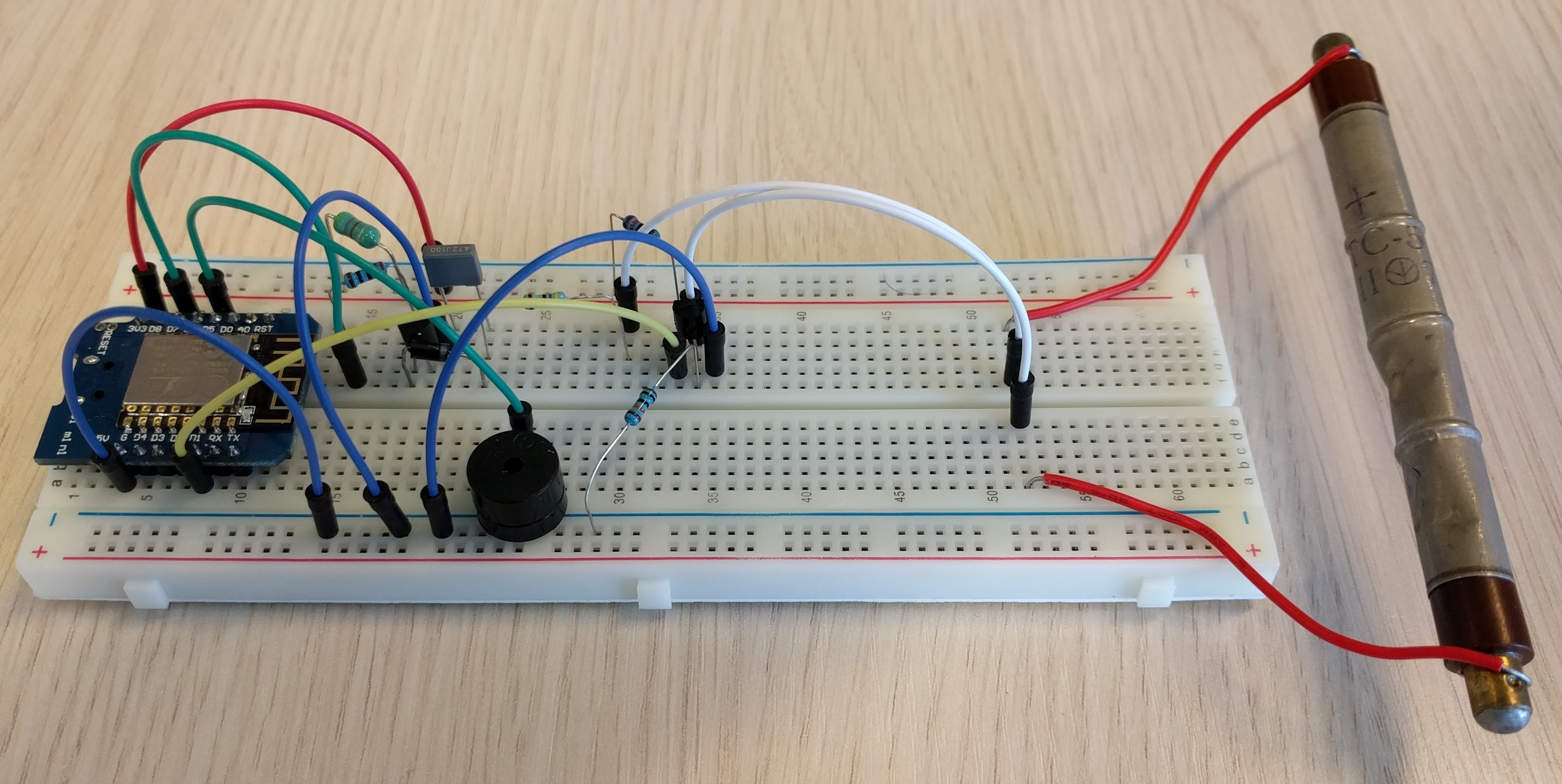

Biemster wanted to improve this counter to an IoT device connected to the network byusing ESP8266 to discover easily where are the harmful radioactive things around.

In a nutshell, driving a G-M tube typically consists of 2 distinct parts:
  1. Providing the tube with a high voltage source for it to operate.
  2. Detecting each ionization event and convert it to a format that can be processed and sent over the internet.
Generating high voltage can be done by using PWM (Pulse-Width Modulation) signals after flashing the ESP8266 with the MicroPython firmware (version 1.8.3, with 10 kHz PWM support). Detection can be implemented as an interrupt handler that listens for and acts on discharges in the tube. Each discharge means a new detection.

You will need the following components:
  • 1x ESP8266
  • 1x STS-5 Geiger tube
  • 1x 4.7 mH inductor
  • 1x 4.7 nF Capacitor
  • 1x KSP44 transistor
  • 1x 2N3904 transistor
  • 1x 1N4007 diode
  • 1x 4.7M resistor
  • 1x 100k resistor
  • 1x 10k resistor
  • 1x 220 ohm resistor
  • 1x optional piezo buzzer
Circuit Schematic
Circuit Schematic
The circuit works as follows: A ~1 Khz squarewave turns the MPSA44 high voltage transistor on and off, generating high voltage when the inductors current is shut off. The voltage depends on the pulse width of the square wave which can be tweaked in software. The 1N4007 diode rectifies this voltage, and the High-Voltage capacitor removes most of the ripple on this voltage. The resistor limits current to the G-M tube. The current pulses from the tube generate a voltage drop over the 100K resistor which turns on the BC546. When this happens the voltage through the 10K resistor is pulled to ground, generating a negative going pulse each time the G-M tube detects an ionizing ray or particle.
The code  reports every event over MQTT, the lightweight IoT protocol. It also reports the CPM (Counts per Minute)  and the time passed since the previous event as (CPM,dt). The library of this project is available at Github, It handles the low level stuff such as PWM and pin assignments, and a general part that will communicate the measurements out to the world.
