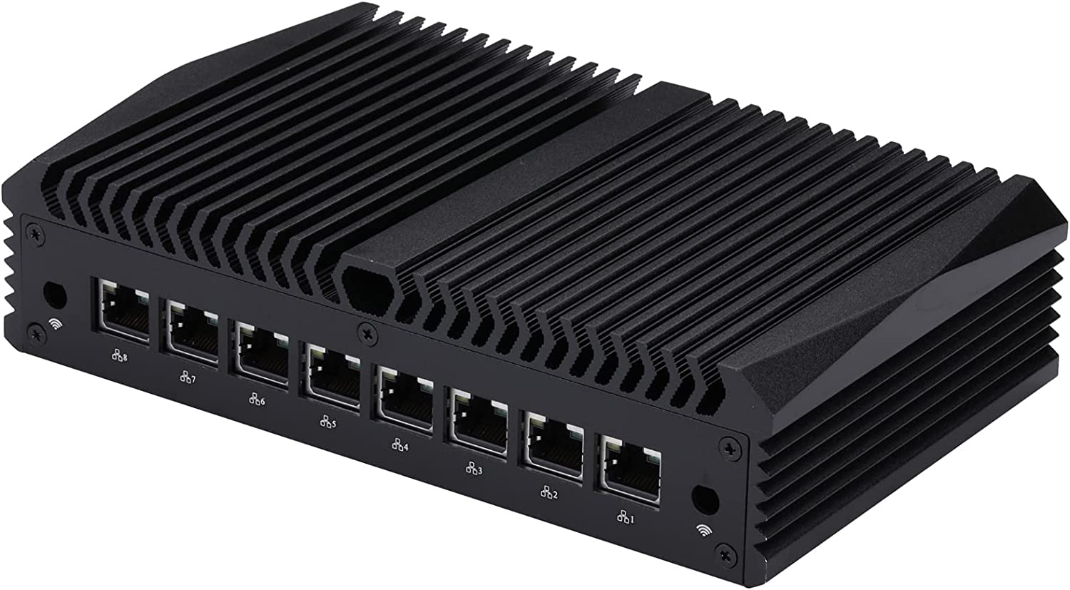

The InuoMicro G4305L8-S2 industrial PC box with eight 2.5GbE ports and a reasonably low cost is well suited for firewalls and other networking applications. It is powered by an Intel Celeron 4305U Whiskey Lake processor.

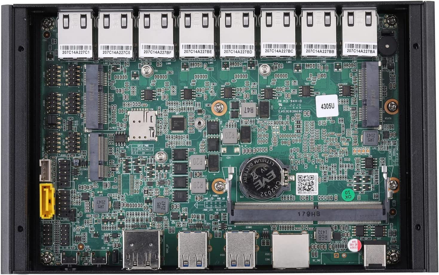

The InuoMicro G4305L8-S2 industrial PC box with eight 2.5GbE ports and a reasonably low cost is well suited for firewalls and other networking applications. It is powered by an Intel Celeron 4305U Whiskey Lake processor. The barebone computer offers interfaces like HDMI and DisplayPort video outputs and a few USB ports, allowing the user to use it as a standard computer. It also supports up to 32 GB RAM, one mSATA SSD, and one 2.5-inch SATA drive. Using mini PCIe and/or M.2 4G LTE and WiFi modules, wireless connectivity can be implemented.

  • The hard drive can also hold one Mini-PCIe for mSATA SSD and one 2.5 “SATA SSD/HDD. (2.5 “Included is a SATA cable)
  • Memory up to 32 GB is supported by 1 x DDR4 SO-DIMM Socket, 2133/2400 MHz.
  • It has one full-length Mini PCIe for 4G and one half-length Mini PCIe for Wi-Fi only. Help USB Devices and M.2 Wi-Fi (E key, 2230)
  • 8 Intel I225V 2.5G LANs are used for the local area network.
  • There is also one SIM card slot, one GPIO, one COMS Clear Jumper, and one Automatically Boot Jumper.
