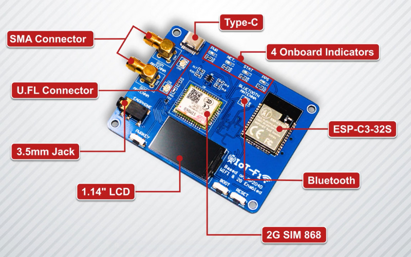

This one’s exciting! A UK-based embedded developer in collaboration with SB Components has designed an IoT development board with support for a rich set of connectivity options. The hardware platform has 2G and 4G cellular connectivity through a separate antenna for both. For 2G, the onboard SIM868 module supports GSM/GPRS and GNSS with low-power consumption and supported frequency bands of 800/900/1800/1900 MHz.
The IoTFi cellular connectivity board is built around the Raspberry Pi in-house silicon tapeout RP2040 microcontroller fabricated using 40nm silicon and comes with an integrated static RAM. The board also has an ESP32, a low-power system-on-chip with support for Wi-Fi and dual-mode Bluetooth wireless connectivity. The board is equipped with a 3.5mm audio jack and an SD card slot to expand the onboard storage.
Apart from the enhanced wireless experience, IoTFi cellular connectivity board features a high-resolution 1.14-inch LCD display for displaying various sensor parameters. There is also an onboard accelerator and Bluetooth 2.0 module, making the hardware platform run next-gen applications. As the company says, “This All-in-One device is capable of calling and transmitting messages to any of your devices.”

Specifications of IoTFi cellular connectivity board:
  • Microcontroller: Raspberry Pi RP2040 microcontroller featuring a dual-core Arm Cortex-M0+ processor core clocked up to a frequency of 133MHz
  • Wireless module: ESP32 system-on-chip with built-in support for Wi-Fi and dual-mode Bluetooth
  • Cellular connectivity: microSIM and SD slots for 2G via SIM868 and 4G via SIM7600G. Also, an inbuilt Bluetooth 2.0 module with support for enhanced data rate and faster PSK modulation
  • Antennas: 2x antennas– GSM and GPS
  • Display: 1.14-inch LCD display with a resolution of 135×240 pixels
  • Audio: 3.5mm audio jack
  • Sensors: Accelerometer module
  • Power: USB Type-C connector for power as well as transmitting data
  • Dimensions:
    • 80×60 mm for 2G variant
    • 100×70 mm for 4G variant
On the software support, the hardware platform provides the flexibility to use several programming languages, such as Arduino, Python, and C/C++. There are several applications that can be built including fetching GPS coordinates, using it as a navigation system, integrating it as a security device, as a vehicle tracking device, as well as a home automation system.
