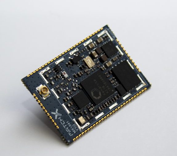

EdgeX AI is built around MatchX’s MX1941 AI System on Module. The MX1941 AI SoM is based on the Kendryte K210 dual-core RISC-V system on chip and a Semtech SX1261 LoRa transceiver in a tiny form factor. The Kendryte K210 is a dual-core 64-bit RISC-V processor running at 400 MHz with KPU CNN hardware accelerator, APU audio hardware accelerator, 6 MB general-purpose SRAM, 2MB AI SRAM memory, and AXI ROM to load user program from SPI flash. Combined with the Semtech SX1261, the MX1941 makes it possible to add long-range radio connectivity for edge AI applications.
MatchX's MX1941 AI SOM
MatchX’s MX1941 AI SOM
The MatchX’s MX1941 isn’t the first AI SoM based on the Kendryte K210, and the SIPEED M1 is also a similar SoM based around the RISC-V processor which is deployed to the Grove AI HAT for the Raspberry Pi. The main difference between both SoM is that the MX1941 provides onboard LoRa connectivity.

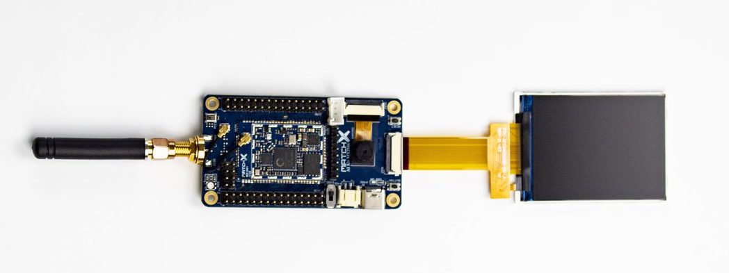

The Edge AI development kit extends the functionality of the SoM. The development kit provides an outlet for a LiPo battery connector, a couple of three buttons acting as some sort of switches, a USB – C female connector port, comes with an integrated microphone, a camera connector, and also an LCD connector.
