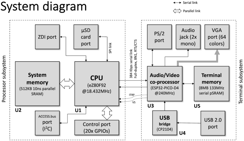

Built with state-of-the-art 21st-century technology, the board design aims at the best trade-off across performance, cost and flexibility. Agon Light comes with an 8-bit eZ80F92 3-stage pipelined CPU running at a blazing clock speed of 18.432MHz and featuring a 24-bit address bus that can directly address up to 16MB of memory and I/O. The board also has an audio-video coprocessor in the form of Espressif ESP32-PICO-D4 system-on-a-chip which runs at 240 MHz, 512KB of SRAM system memory, and 8MB of SRAM audio/video memory.
Other features which make the board fit as both a microcomputer and a microcontroller include a microSD card, VGA video output, and GPIOs.
“As a microcomputer,” the Byte Attic blog explains, “Agon is a standalone device that requires no host PC: it puts out its own video (VGA), audio (2 identical mono channels), accepts a PS/2 keyboard and has its own mass-storage in the form of a µSD card. As a microcontroller, it has a control port featuring SPI, I2C, twenty or more distinct GPIO lines (including lines for serial communication), a system clock output, as well as power (3.3V and 5V) and ground rails.”

  • CPU: eZ80F92 running at 18.432 MHz; 24-bit address bus
  • ESP32-PICO-D4 VDP (Video Display Processor)
  • 512KB of SRAM system memory
  • 8MB of PSRAM audio/video memory
  • VGA output with 640 x 480 pixels resolution and 64 simultaneous colors
  • 1x microSD card slot for storage
  • PS/2 Keyboard slot
  • 20x GPIO, plus SPI, I2C, UART for serial communication
  • Input Power: 5V via either USB or GPIO port
