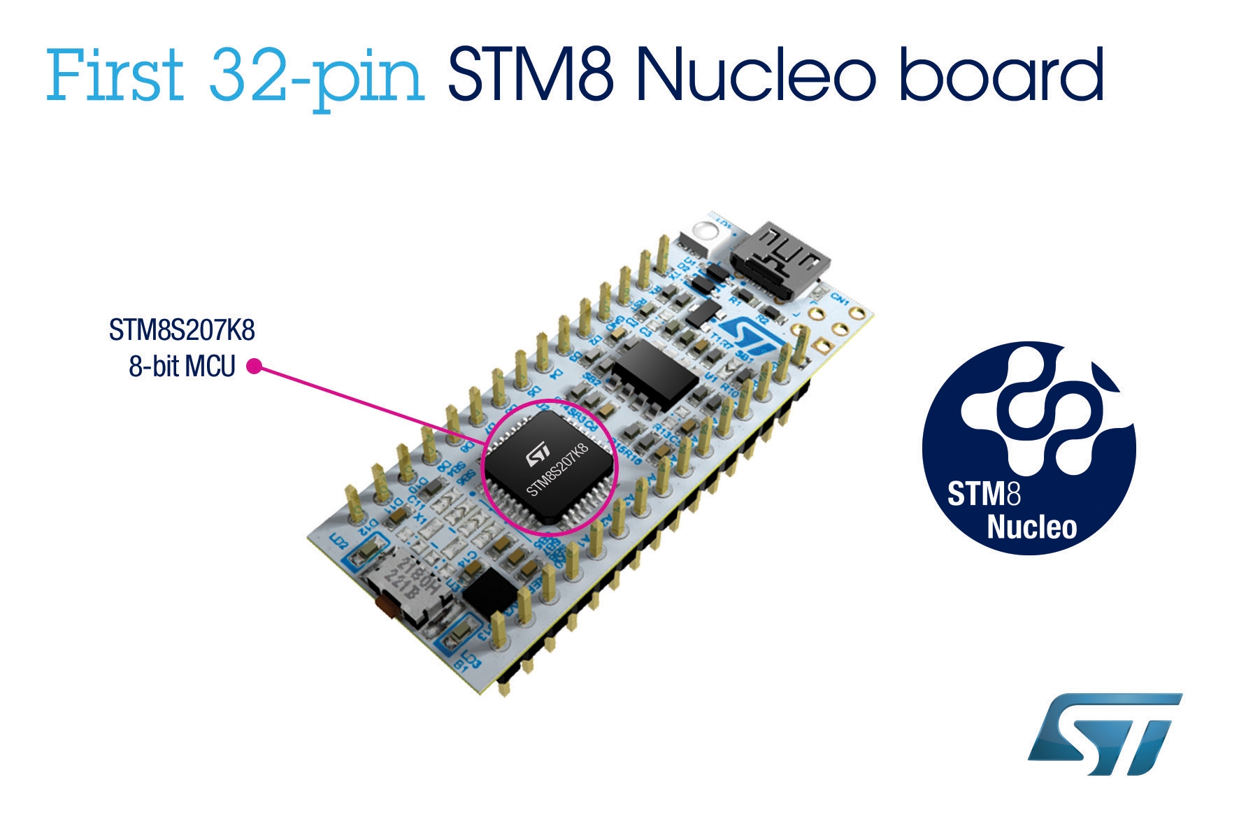

The first available STM8 Nucleo-32 board, the NUCLEO-8S207K8, contains a 32-pin STM8S207K8 MCU, which provides features including 12 high-current outputs and multiple capture-compare channels.
Features of the NUCLEO-8S207K8 STM8 Nucleo-32 board include
  • STM8S207K8T6C microcontroller in LQFP32 32-pin package
  • 4 LEDs:
    • USB communication
    • Power
    • User
    • Default
  • 1 reset push-button
  • Board connectors:
    • ARDUINO® Nano V3 expansion connector
    • Micro-B USB connector for the ST-LINK
    • SWIM interface
  • Flexible power-supply options: ST-LINK USB VBUS or external sources (3.3 V, 5 V, 7 V – 12 V)
  • On-board ST-LINK/V2-1 debugger/programmer with SWIM connector and USB re-enumeration capability: mass storage, Virtual COM port and debug port
  • Comprehensive free software STM8 libraries including a variety of software examples
  • Support of a wide choice of Integrated Development Environments (IDEs) including STMicroelectronics free STVD-STM8 (using Cosmic toolchain), IAR™, Cosmic free IDEA
