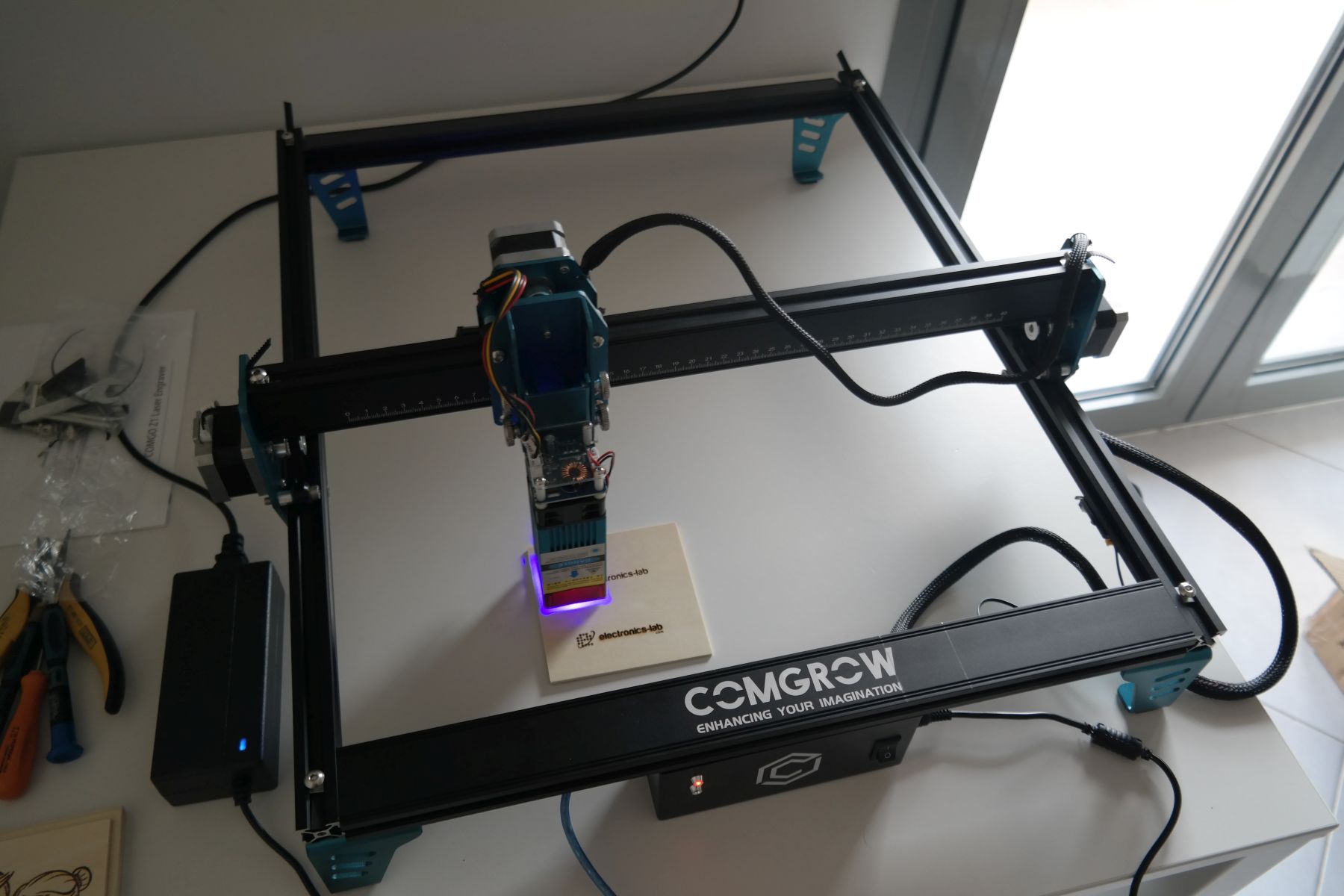

Laser engravers/cutters like 3D printers are bringing small-scale manufacturing closer to makers and hobbyists. As the technology advances, the competition between companies making them is getting stiffer, leading to the market being flooded with different types and makes, making it difficult for the average maker/hobbyist to select one. To simplify decision-making for readers, our review articles help spotlight top-of-the-line products/tools that we have enjoyed using, and for this article, in the spirit of laser engravers, we will be reviewing the COMGO Z1 desktop diode laser engraving machine from additive manufacturing solutions expert COMGROW. This is a China-made laser engraver with a simple design approach, consisting of 4 x aluminum bars and 4 x legs, a pre-assembled Y-axis with the two motors, a 5W laser module, and the USB control unit.

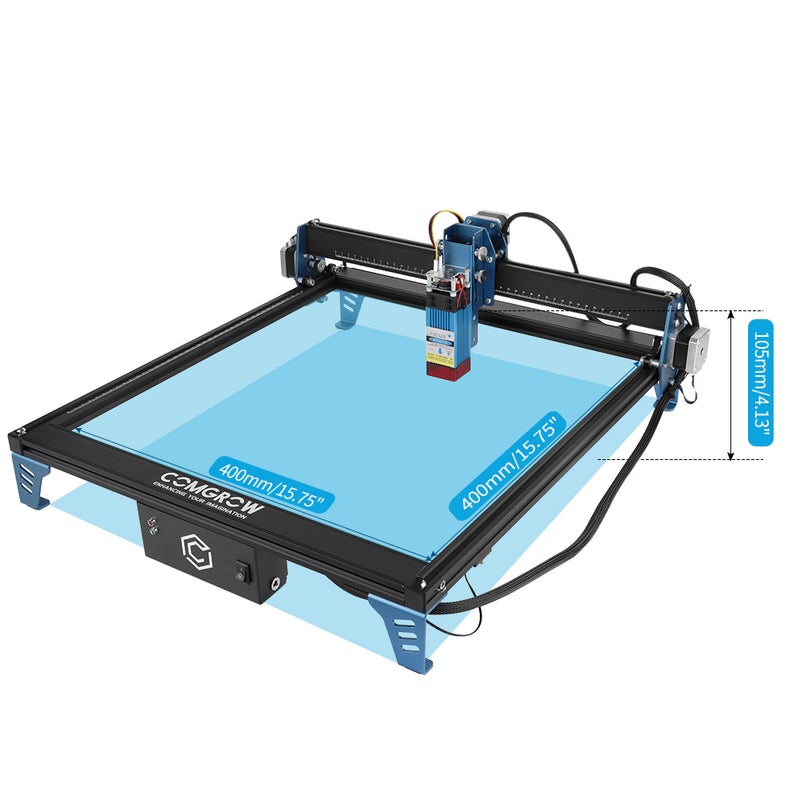

Packaged as a pre-assembled kit comprising of four profiles which when put together gives a 400 x 400mm working area, the COMGO Z1 is a quick setup laser engraver designed to provide hobbyists, makers, and DIY enthusiasts with a pocket-friendly Laser engraver with top of the line performance and features.

Featuring an LD+FAC-based diode laser, it’s a big contributor to the standout features and performance of the COMGO Z1 is its laser head. The Z1 uses a 5W (upgradeable to 10W) high-power compression laser head, with an incredibly accurate, 80 um (0.08 x 0.08mm) laser spot diameter which creates room for a wide range of tint and burns, altogether making it possible to accurately cut and engrave a wide range of materials such as aluminum (like 7075-T6), plywood, kraft paper, leather, plastic, cardboard, wood, non-woven fabric, bamboo, acrylic, film-coated glass, and many more, at a great speed and accuracy.

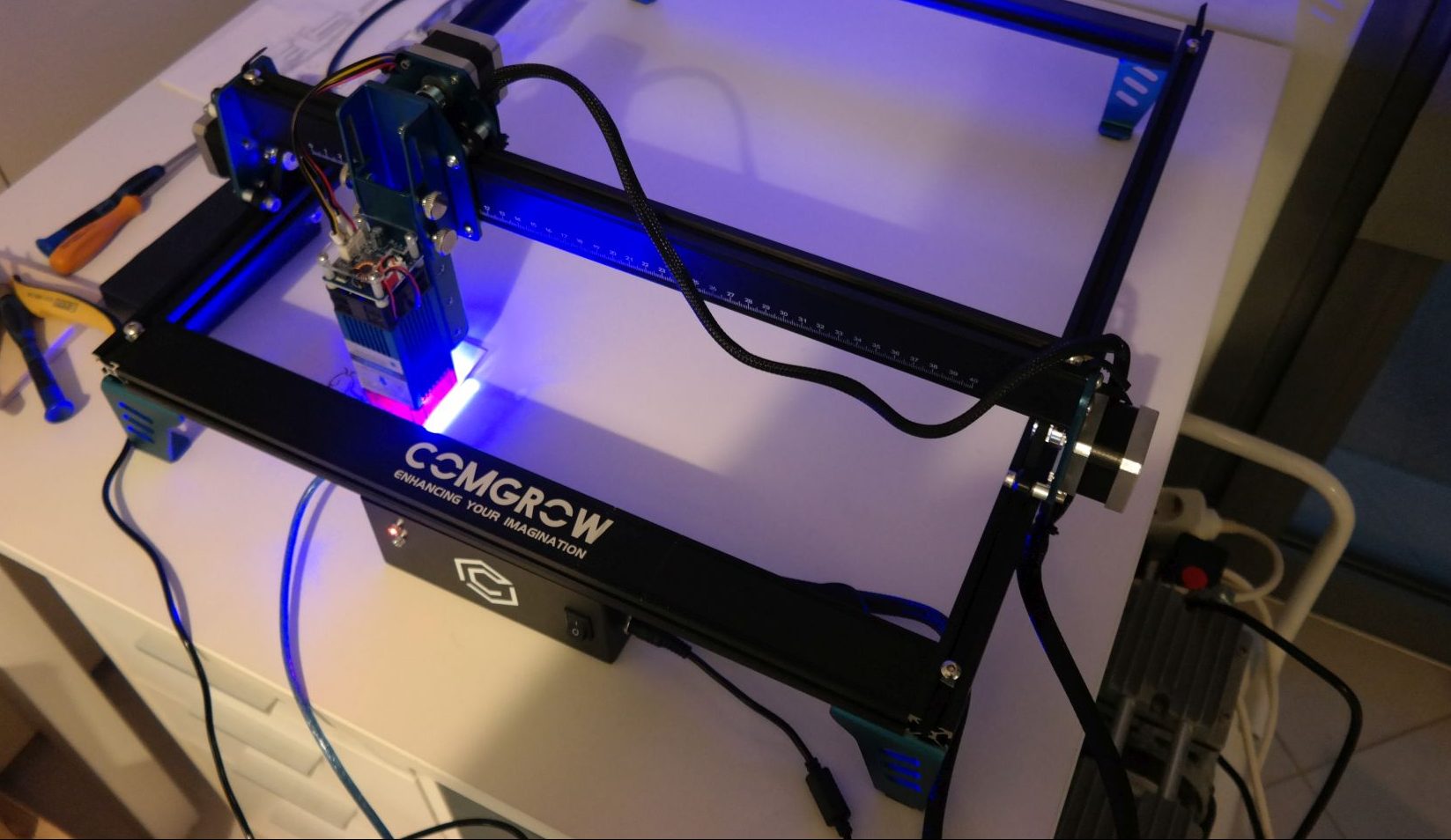

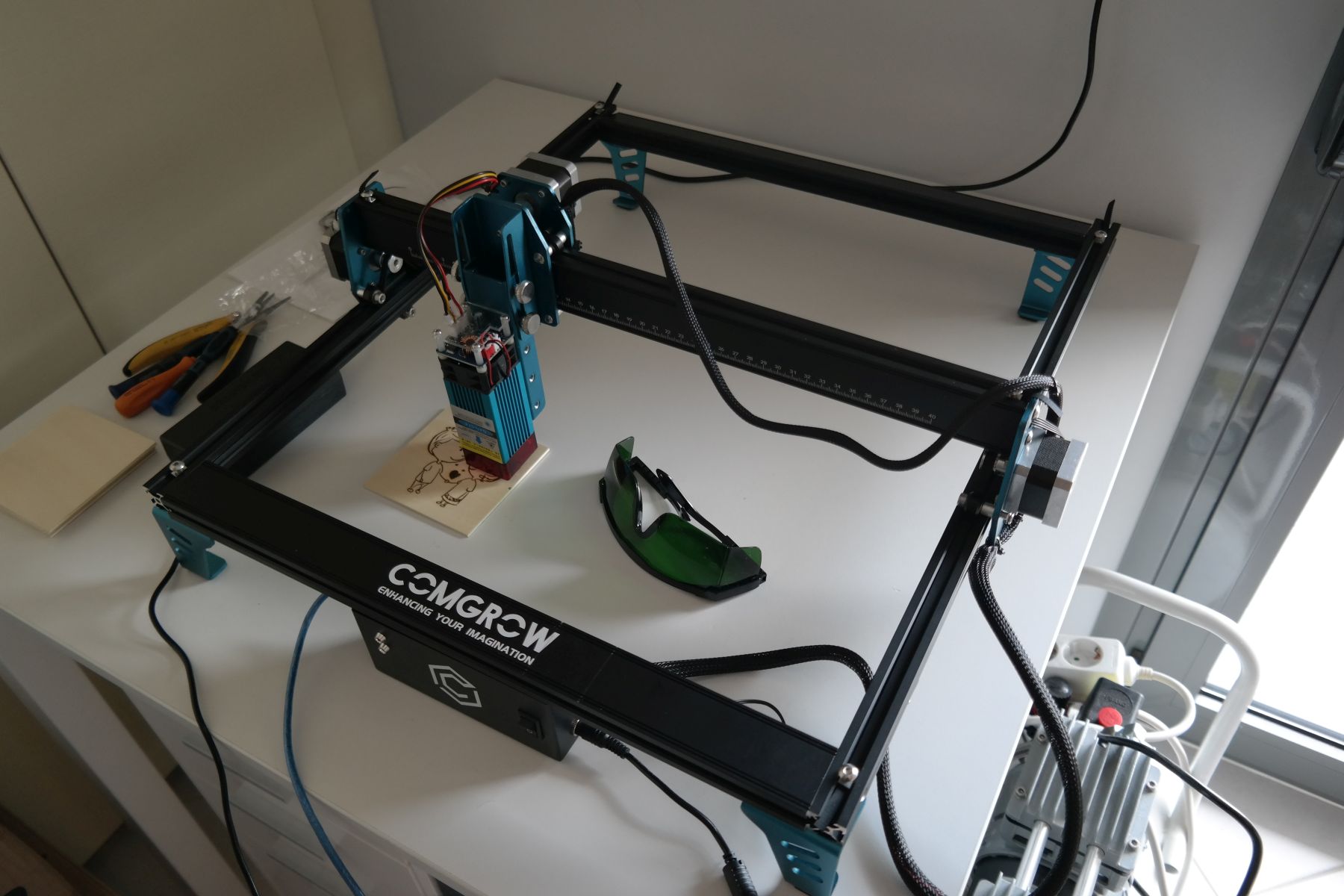

The assembly process took us about 30-45 minutes to complete following the draft instructions on the small manual that came in the box. First, you need to attach the 4x aluminum bars together forming a large rectangle, and secure them with the available screws. At first, you will find yourself questioning which side goes up and which is back or forth as these details are not clear on the manual photos. This is important to note the company’s logo should face up and be to the front, the scale should be face to top and be on the left side and the limit switch should be placed on the right side and close to the front section (the one with the logo). After some trials and errors, we managed to assemble the frame successfully. Then we took out the pre-assembled Y-axis and rolled it from back to front so that it locks between the bars and be able to freely move. The next step was to place the 2 x silicon belts in the cavity of the left/right bars and secure them with some screws. Then we passed the belts on the stepper motors and tested the movement of the Y-axis to be smooth. Be careful to connect the stepper motor cables to each of the motors as these come disconnected. Next, was time to attach the laser module. This was easy enough using 2 x screws and securing on the Z-axis. Some attention must be taken to attach the cables on the laser module and this is not clearly indicated on the manual and these connectors are polarized. Check the photo below to see how these have to be connected.

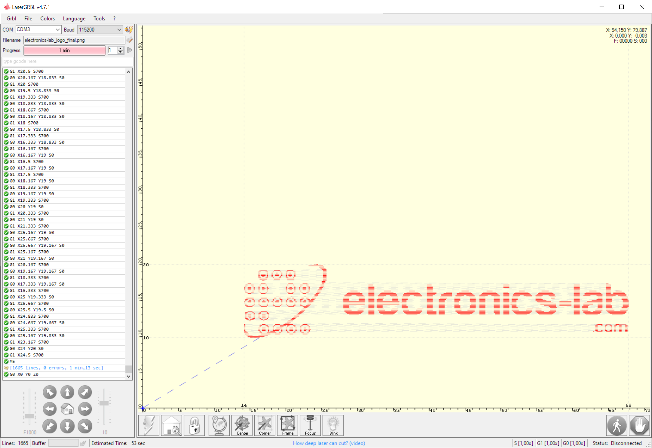

The COMGO Z1 supports both Windows and Mac systems. We will focus on the Windows software proposed in the manual which is the open-source and popular LaserGRBL. This is the basic software that seems to do the job. There are no fancy icons or user interfaces, as you can see on the screenshot above. At the first launch, you will have to go to Tools -> Install CH340 Driver so that the software will be able to communicate with your laser engraver over a USB connection. Then connect the USB cable and power on the device. Please note that in case you have connection issues, it’s advisable to do a firmware update based on the instructions on the attached link. Then click on the connect icon which is located next to the preset Baud Rate of the serial to USB bridge. Baud should be 115200bps.
If everything is fine your engraver should connect to the software and you are ready for your first print. Click the icon below the connect icon and load one of the provided graphics. A popup window will show up with some parameters to set up, then click next and be sure to define the size of the image based on your material to be burned.
You will need to move the laser module to the edge of your material, align the material and click on Define the zero point. Then you are ready to click the Play icon and start the engraving process. You may find yourself that you need to do some tests and trials and errors before you manage to print your first image. It needs some experience to make this work on the first try. Take your time to learn how the software works and be sure you will successfully make your first burn.

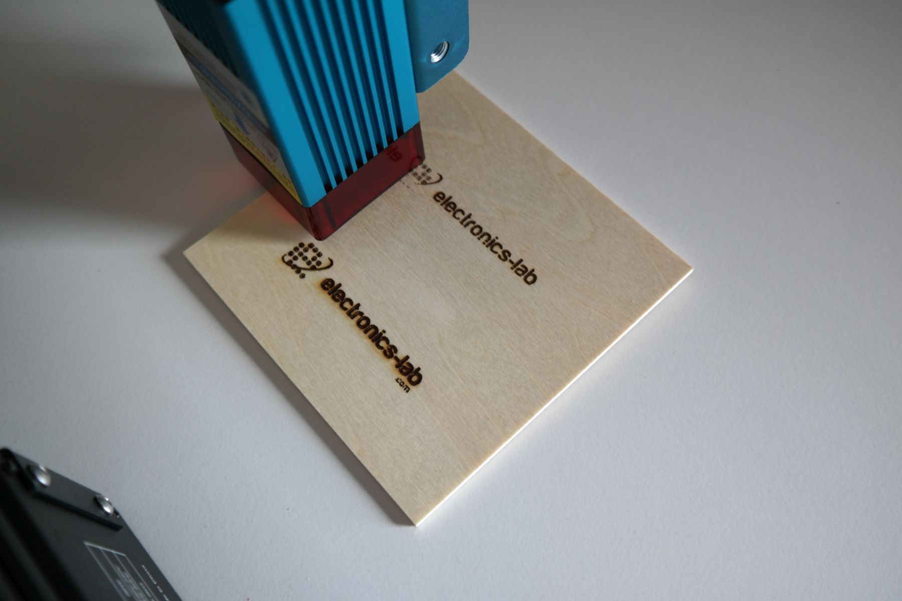

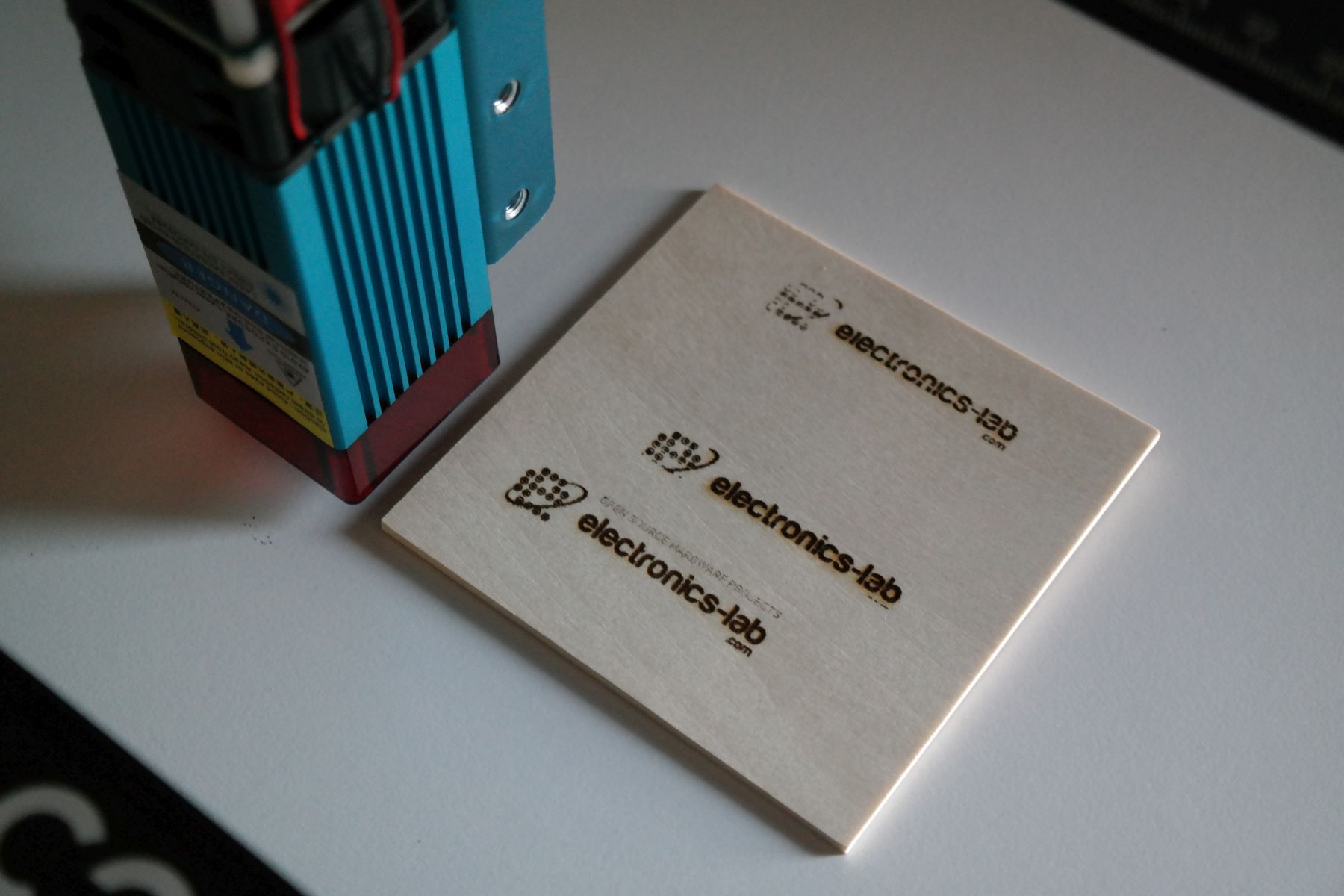

To test the COMGO Z1 Wood Laser Cutter Engraver, we loaded our logo on the LaserGRBL software, set up some parameters on the window opened and then it’s was time to align the material with the zero point. After that, we push the GO button and the engraving started right away. To etch our logo on the small wood piece a few minutes was all that it needed. You will notice that you may need to experiment with the software parameters in order to achieve the best result. One important parameter is laser power. As you can see in the photo below the laser power was to the max and that resulted in an overburn engraving. On the second engraving above we set the laser power to 50% and the letters were etched better but not the logo itself. This means that we need to experiment more with the LaserGRBL software to find the ideal settings.

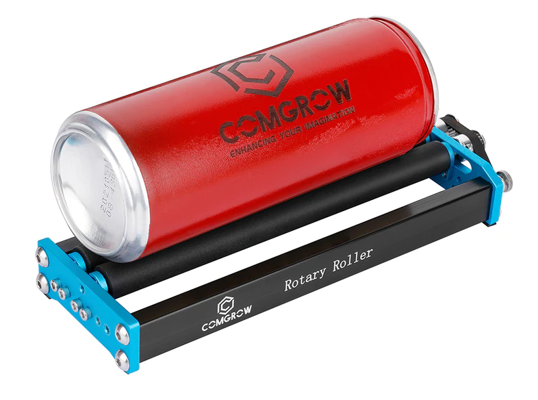

Another notable thing about the COMGO Z1 is the available upgrades. Thanks to COMGROW’s large ecosystem devices, the capabilities of the Z1 can be further enhanced with a variety of superb upgrades. For example, the 5W laser head can easily be replaced by a 10W version which brings in more cutting and engraving power. Feature upgrades can also be achieved by using add-ons like the COMGROW Laser Rotary Roller Engraving Module which allows users to engrave on/around round and cylindrical objects. as big as the travel size as the Z1.
