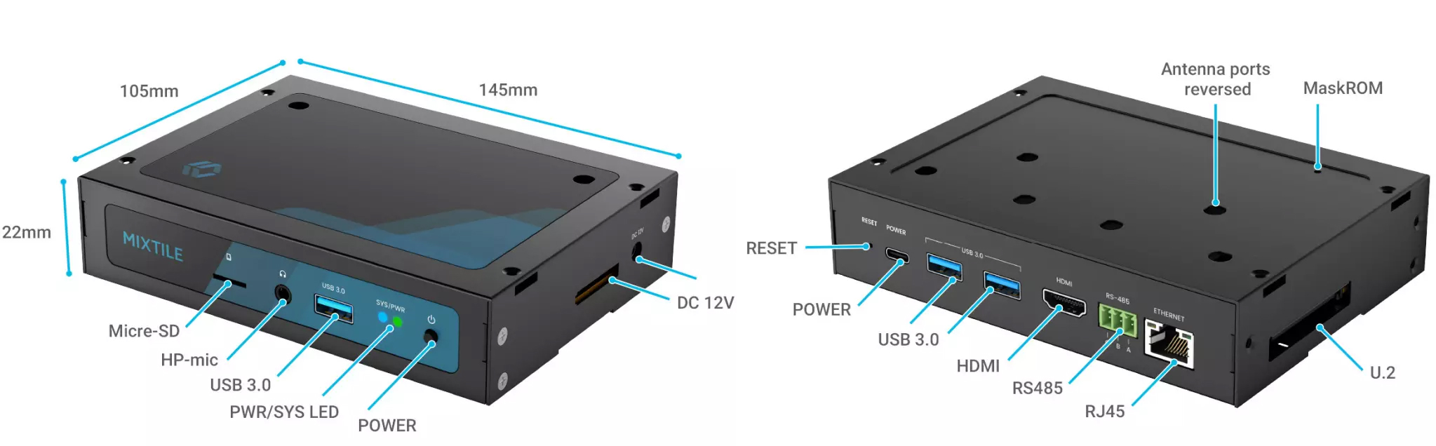

This 3.5-inch industrial mini PC features Gigabit Ethernet, WiFi 6, three USB 3.0 ports, M.2 and mPCIe expansion sockets, and a U.2 connector similar to the Mixtile Blade 3 SBC’s, albeit with different interface routing.
The U.2 connector on the RK3588 board supports PCIe 2.0, enabling USB 2.0, Gigabit Ethernet, SPI, and I2S interfaces. Mixtile introduces a router add-on with four Ethernet ports and a Hi-Fi add-on with RCA and S/PDIF inputs. The 20Ah battery pack, powered via a 12V SATA port, contains five 18850 batteries (4,000 mAh each), ideal for renewable energy setups, offering advanced battery management for safe shutdowns.

  • SoC: Rockchip RK3568 quad-core Arm Cortex-A55 @ 2.0 GHz, Mali-G52 EE GPU, 0.8 TOPS NPU
  • Memory: 2GB or 4GB LPDDR4
  • Storage:
    • 16GB or 32GB eMMC
    • MicroSD 3.0 slot
    • NVMe SSD support via M.2
  • Video Output:
    • HDMI 2.0
    • On SBC: 2x MIPI DSI, eDP
  • Camera Interface: On SBC: 1x MIPI CSI
  • Audio: 3.5mm jack, HDMI digital audio, DMIC
  • Connectivity:
    • Gigabit Ethernet RJ45
    • WiFi 6 (802.11ax) and Bluetooth 5.0 (AP6275S)
    • 4G/5G support via M.2 or mPCIe, 2x SIM card slots
    • Multiple antenna support
  • USB: 3x USB 3.0, 1x USB 2.0 Type-C (power)
  • Serial: RS485 (3-pin), CAN Bus
  • Expansion:
    • M.2 (PCIe 3.0, USB 2.0)
    • Mini PCIe (USB 2.0, I2C)
    • U.2 (SATA/PCIe 2.0, USB 2.0, Gigabit Ethernet, SPI, I2S)
    • Internal headers (ADC, 2x UART, I2C)
  • Misc: RTC, backup battery, LEDs, Reset/Maskrom pinholes
  • Power Supply:
    • USB-C PD (20V/3A)
    • 12V DC jack
    • 12V DC via SATA
  • Dimensions: 145 x 105 x 22mm
  • Temperature Range: 0 to +80°C
