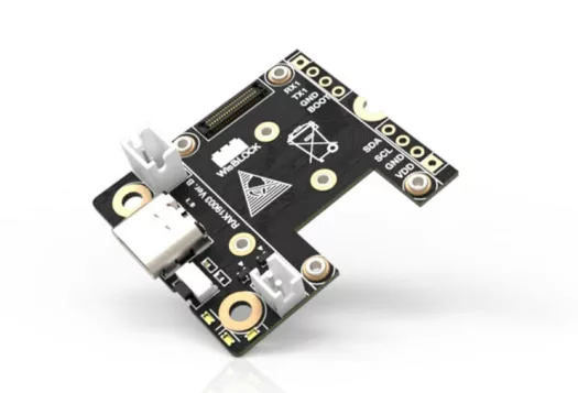

RAK19003 WISBLOCK BASE BOARD (the smallest WisBlock baseboard so far)
Features and Specifications:
  • Wisconnector for WisBlock Core MCU
  • 2x 24-pin Wiconnectors for WisBlock modules
  • I2C, UART, GPIOs and analog input
  • USB Type-C debug port
  • 1x Reset button
  • 2 user-definable LED’s

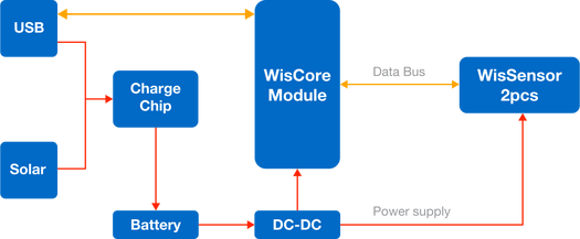

  • 5V power supply via USB port/3.7V power supply via LiPo batteries/5V via solar panel(s)/Combination of multiple power inputs
  • Dimensions: 35 x 30mm
The baseboard is currently available for $8.99. Other details can also be found on the company’s website.
