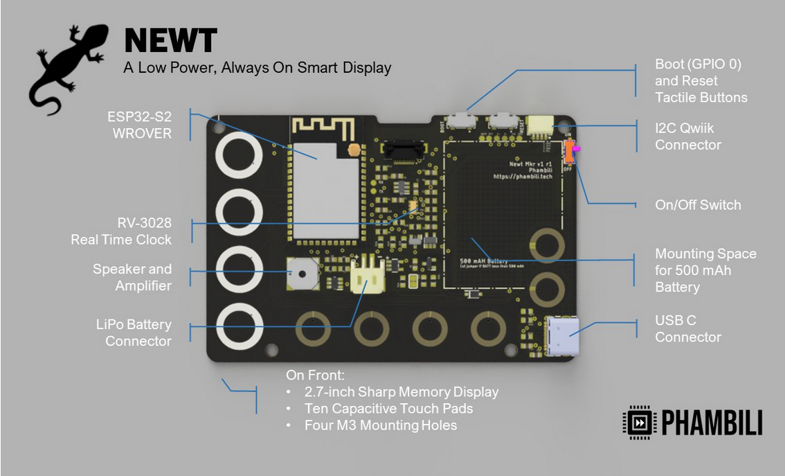

Newt features a 2.7-inch, 240 x 400-pixel MiP LCD which can deliver high-contrast, high-resolution, and low-latency content with ultra-low power consumption Reflective mode leverages ambient light to eliminate the need for a backlight. It also features a speaker/buzzer with mini class-D amplifier on DAC output A0 which can play tones or lo-fi audio clips. Newt can operate for one to two months between charges thanks to its 500 mAH LiPo battery. It features a USB Type-C connector for programming, power, and charging. Its low-quiescence voltage regulator (TOREX XC6220) is capable of providing an output 1 A of current and operating as low as 8 uA. Additional features include a JST connector for a Lithium-Ion battery, battery-charging circuity (MCP73831), and a low-battery indicator (1uA quiescence current).
