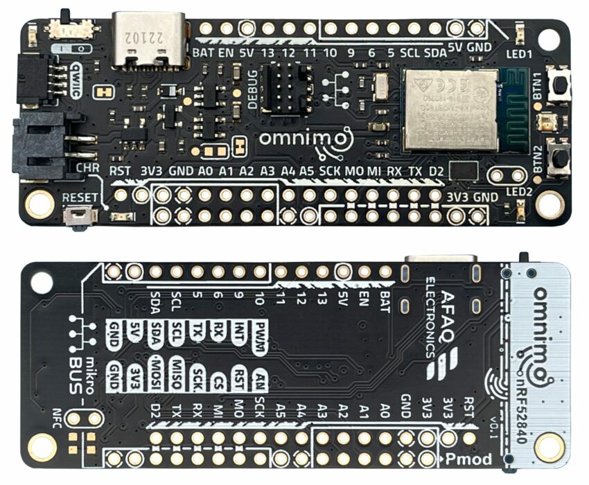

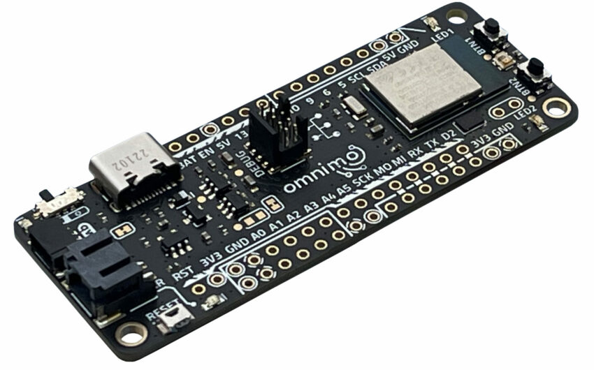

The Omnimo nRF52840 is a compact development board designed for IoT prototyping and automation system integration. It is powered by the Nordic nRF52840 SoC, which features a 64 MHz Arm Cortex-M4 MCU with a floating-point unit (FPU), 1 MB Flash, and 256 KB RAM. The board supports Bluetooth 5.4, Bluetooth Mesh, NFC, Thread, Matter, and Zigbee through its 2.4 GHz radio. An additional 2 MB external QSPI flash enhances storage capacity.
The board provides 26 GPIOs and supports multiple expansion interfaces, including mikroBUS, Feather, Pmod, and Qwiic/Stemma QT. This allows compatibility with various add-on modules, making it suitable for various IoT applications. It also includes two programmable push buttons and LEDs for user interaction.
Designed for modular connectivity, the Omnimo nRF52840 condenses the features of larger development kits into a smaller form factor, slightly larger than the Adafruit Feather. Its pin and port layout enables seamless integration with over 2,000 available modules, making it a versatile option for embedded hardware development.
Omnimo nRF52840 IoT development board specifications:
  • Processor & Wireless Connectivity
    • Nordic nRF52840 SoC (MDBT50Q-1MV2)
    • 64 MHz Arm Cortex-M4 processor with FPU
    • Multi-protocol 2.4 GHz radio: Bluetooth 5.4, Bluetooth Mesh, Thread, Matter, Zigbee, and proprietary protocols
  • Memory & Storage
    • 1MB Flash, 256KB RAM
    • 2MB external QSPI Flash
  • Interfaces & Peripherals
    • Communication interfaces: SPI, UART, I2C, I2S, USB
    • 12-bit, 200 ksps ADC with 8 channels
    • 4 PWM channels
    • ARM CryptoCell cryptographic unit
    • On-chip NFC-A tag for pairing and payment applications
    • 26 GPIO pins
    • 2 user buttons, 1 reset button
    • 2 user LEDs, 1 NeoPixel RGB LED
  • Expansion & Module Sockets
    • Feather-compatible pinout (supports Adafruit FeatherWings)
    • mikroBUS socket (compatible with Click modules)
    • Pmod connector (supports Digilent Pmod modules)
    • Qwiic/Stemma QT connector (I2C expansion)
  • Programming & Debugging
    • USB bootloader for firmware updates
    • SWD connector for debugging
    • Over-the-air (OTA) programming
  • Power Management
    • 1.8V to 3.3V regulated output for external components
    • Battery connector supporting 3.7V–4.2V Li-Poly batteries
    • On-board 3.3V LDO regulator
    • Controllable LDO regulator for external modules
    • Side on/off switch
  • Dimension: 68 mm x 25.4 mm (2.6″ x 1″)

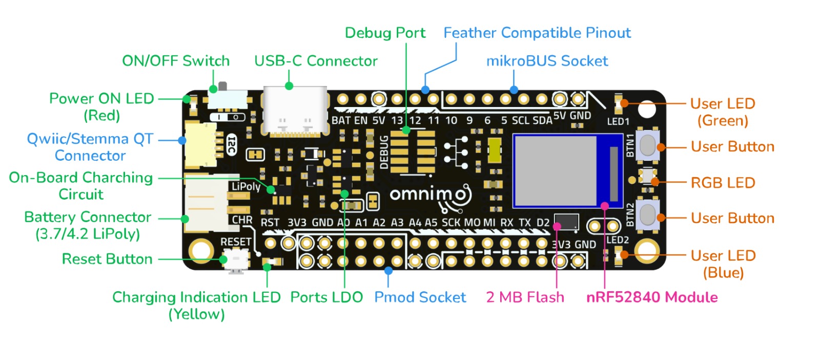

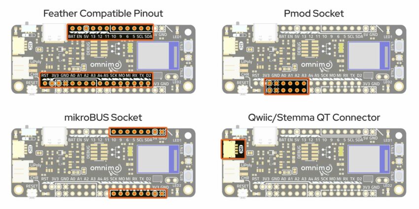

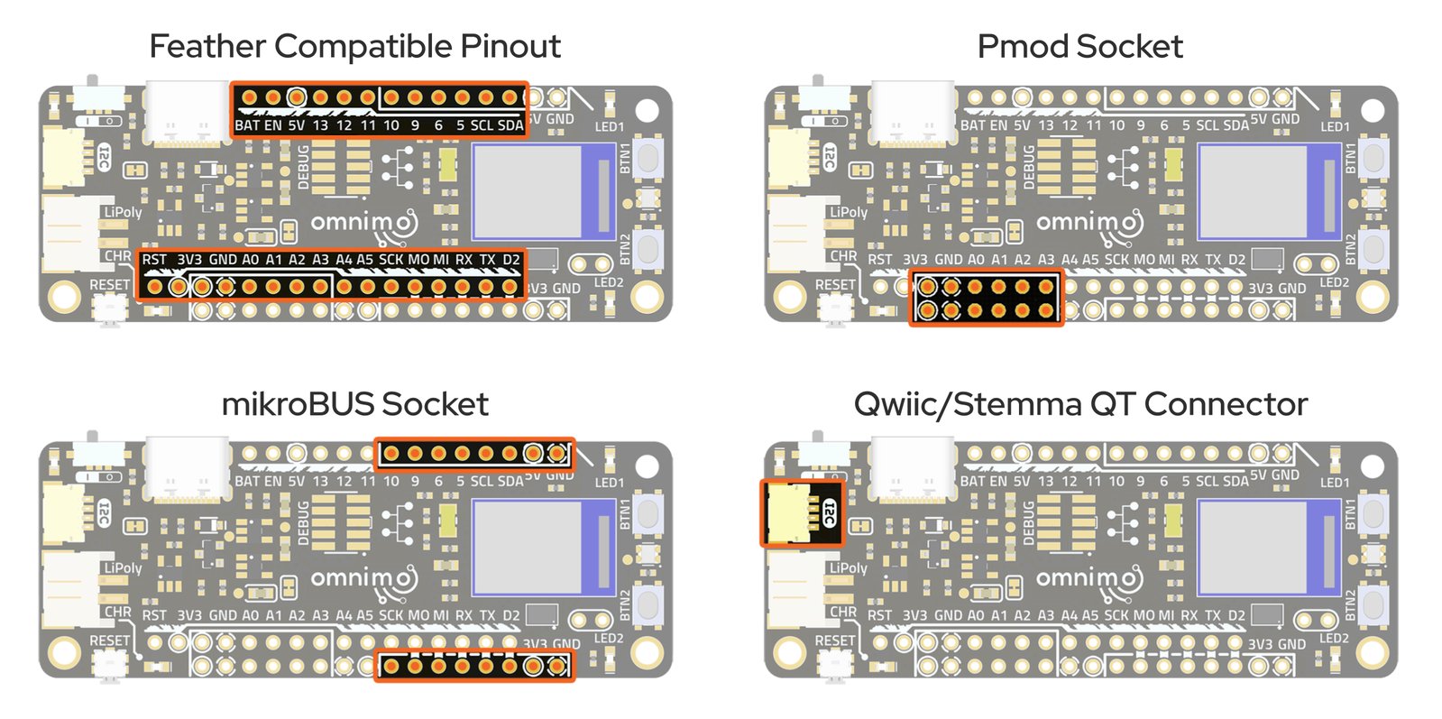

The Omnimo nRF52840 stands out with its versatile pin headers and module sockets, supporting a wide range of expansion boards. It is compatible with Adafruit FeatherWings, mikroBUS Click modules, and Digilent Pmod modules, providing developers with flexibility. Additionally, it features a Qwiic/Stemma QT header, which can support Grove modules through an adapter. Similar to Adafruit Feather boards, it includes a LiPo battery header and an onboard battery charging controller for portable applications.
omnimo-nrf52840
Omnimo nrf52840 socket locations

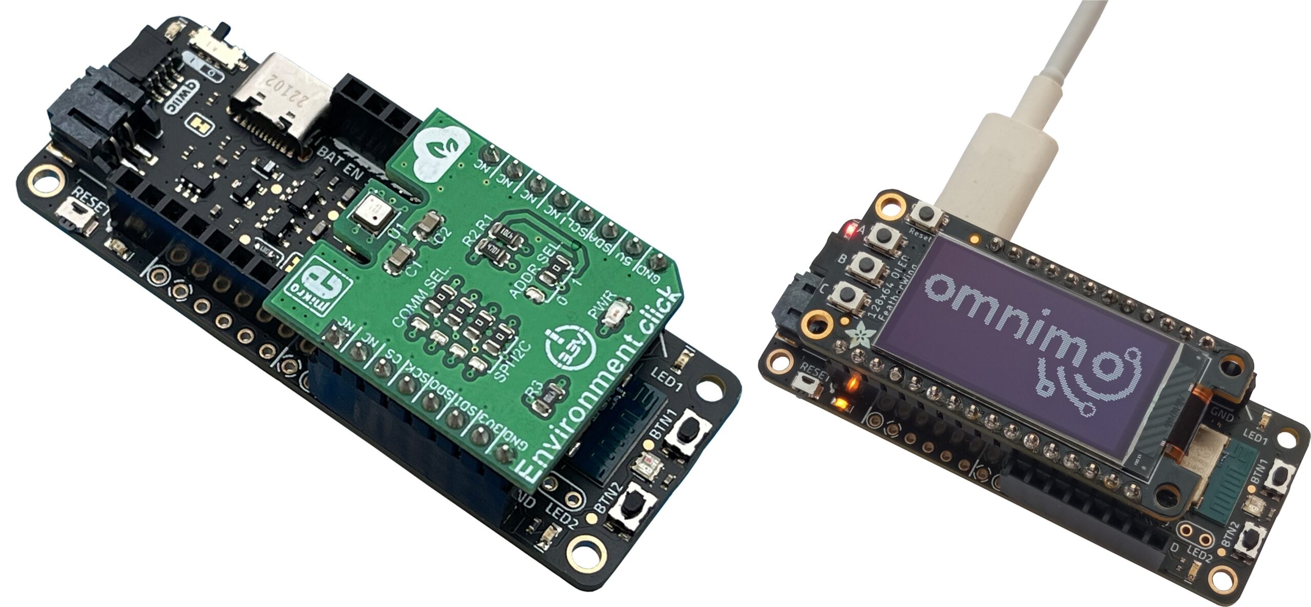

Omnimo nRF52840 with feather wing-OLED and mikroBUS Click
