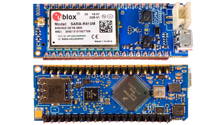

Front and Back of IoTa
Talking more about the IoTa, the board features a u-blox SARA-R410 modem for rapid IoT development on CAT-M and NB-IoT networks worldwide. This is a cost-efficient solution offering multi-band data transmissions for Low Power Wide Area solutions in a compact form factor. The modem is ideal for mission-critical IoT solutions, as it includes a unique and immutable root-of-trust. They support IoT Security-as-a-Service and provide the foundation for a trusted set of advanced security functionalities.
