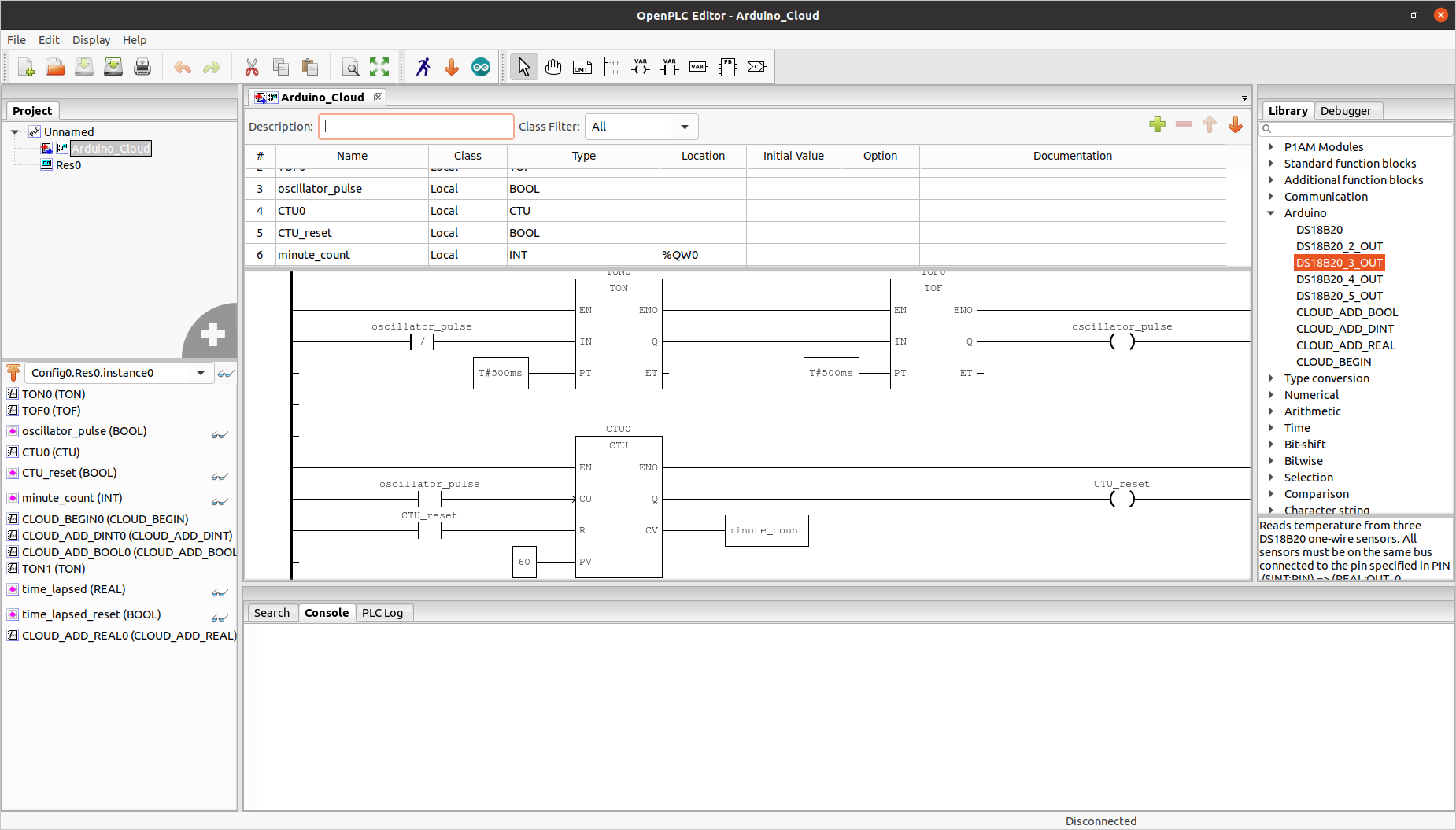

OpenPLC is a fully-featured standardized Programming Logic Controller Suite that officially supports a variety of platforms such as Arduino, Raspberry Pi 2/3/4, Windows, and Linux. This openPLC consists of two main parts named the Runtime software and the programming Editor.
OpenPLC is a fully-featured standardized Programming Logic Controller Suite that officially supports a variety of platforms such as Arduino, Raspberry Pi 2/3/4, Windows, and Linux. This openPLC consists of two main parts named the Runtime software and the programming Editor. While you use the Editor to create, design, compile, and upload your PLC programs, you use the Runtime to execute the programs that you have created on the Editor.
The Editor IDE is very easy to use and offers more flexibility when it comes to programming a PLC.  It is IEC 61131-3 standard compliant and thus supports the five high-level programming languages defined in it– Ladder Logic programming, Function Block Diagram, Instruction List, Structured Text, and Sequential Function Chart. Compared to Arduino PLC IDE where all the programming languages defined by the IEC 61131-3 standard are licensed and you have to pay almost $18 for their Potenta Machine control PLC key, this PLC IDE is completely open source and does not require you to pay license fee for any of the programming languages that it supports. You are only charged for buying copies of the standard, as required by IEC.
