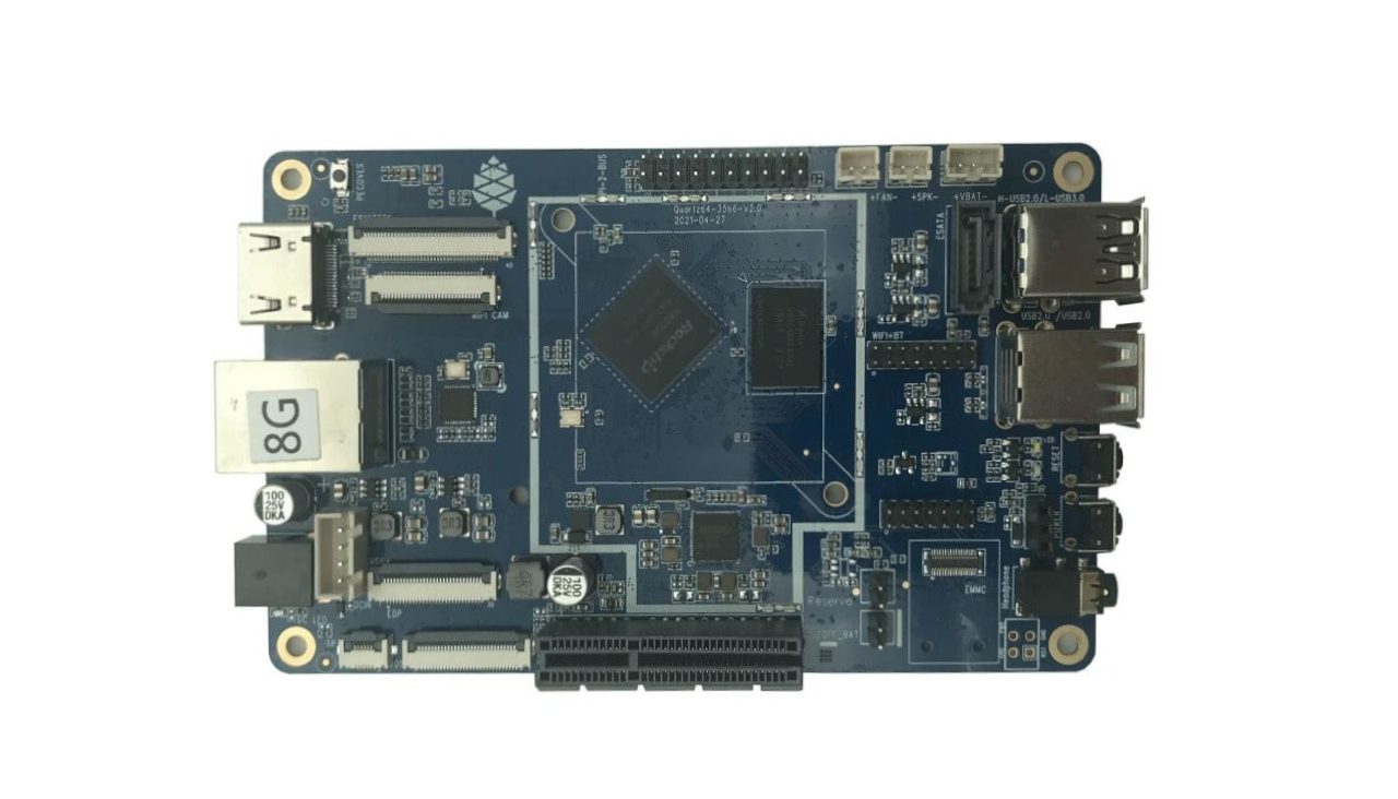

The manufacturer planned to split the Quartz64 SBC line in two, similar to the Raspberry Pi family, with a Model A and a Model B. The 133 x 80 x 19mm Quartz64 model-A harnesses the capabilities of Rockchip RK3566. The RK3566 features a quad-core Cortex-A55 processor clocked up to 1.8 GHz frequency. It also comes with a Mali-G52 2EE Bifrost GPU running at 800MHz, and an integrated neural processing unit (NPU) coprocessor that delivers 0.8 TOPS of performance.
The developer-focused model-A is compatible with LPDDR4 memory options ranging from 2GB to 8GB, depending on the user’s needs. It will also support a Gigabit Ethernet port along with optional wireless connectivity of Wi-Fi 802.11 b/g/n/ac and Bluetooth 5.0. In addition to the MIPI-DSI, eDP, and E-ink interfaces, the SBC supports an option for 16GB to 128GB eMMC modules. It also comes with a microSD card for removable storage.
Quartz64 Model-A Board
Talking about the Quartz64 model-B, it is expected to be released in the coming months. According to Pine64, the Model-B will have either a BL-602 RISC-V 802.11n and BLE 5.0 module, which is currently open-sourcing, or an AP6256 802.11ac WiFi + Bluetooth 5.0 module. The compact size makes this device a great choice for education, tinkering, personal projects, and similar applications.
The main difference between the two models is in their connectivity. The Quartz64 Model B lacks the Model A’s SATA port, embedded DisplayPort (eDP) interfaces. Along with this, the MIPI-DSI and -CSI interfaces are two-lane rather than four-lane. The Model B also removes the touch-panel controller and charging circuit. On the other hand, Model B provides user-friendly features. These include onboard Wi-Fi and Bluetooth connectivity and a 40-pin GPIO header rather than the 20-pin header on the Model A. Additionally, Model B has an M.2 slot instead of a PCIe interface.
A developer can build many exciting projects with the Quartz64 SBC. Nevertheless, Pine64 plans to leverage the Quartz64 model-A as a development platform for its next-generation smartphones, laptops, and other devices. Model-B is still under development, while model-A has begun selling to community members.

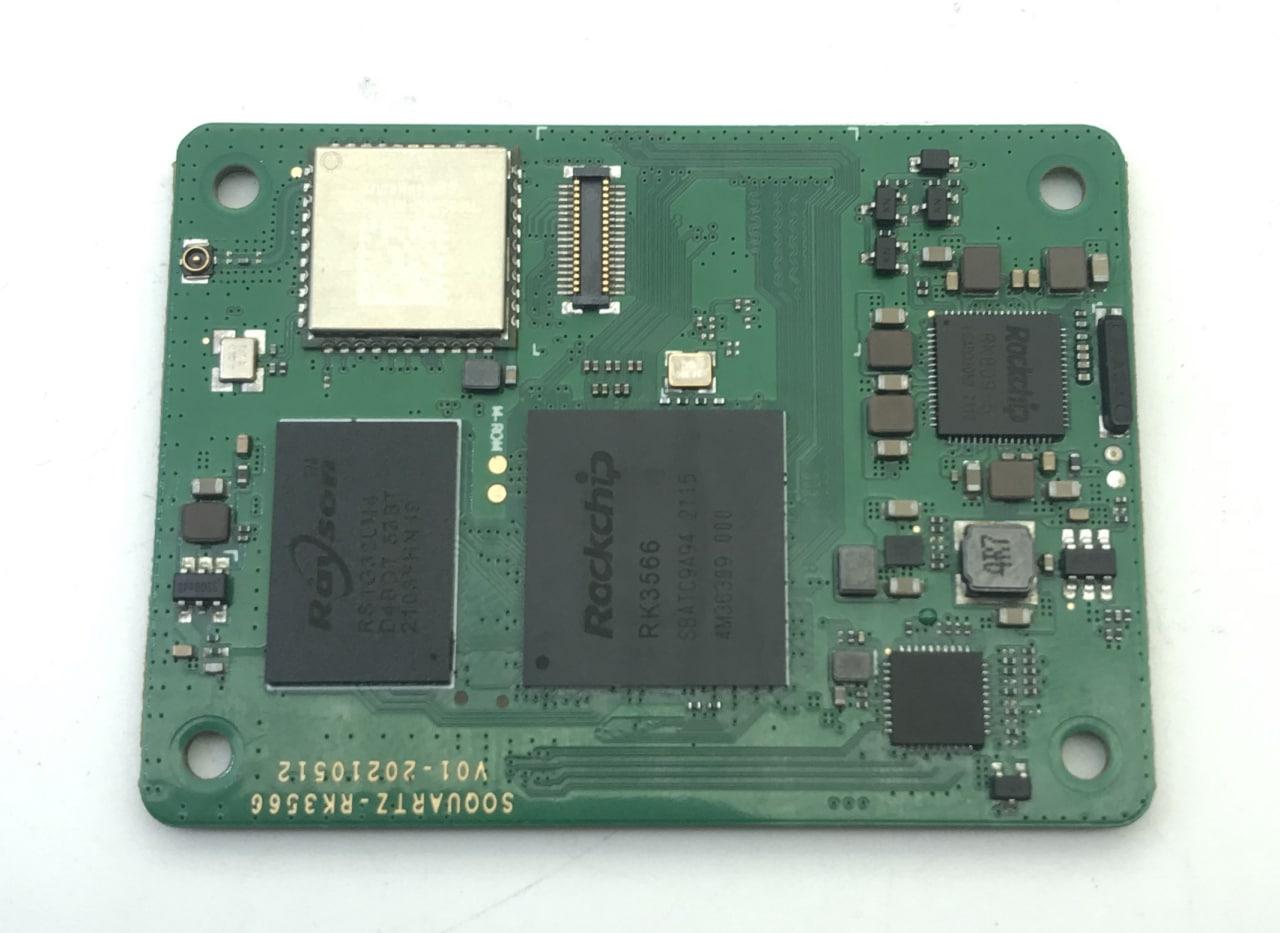

The firm also unveiled the SOQuartz module. It is a compute module that may be a drop-in replacement for the Raspberry Pi Compute Module 4. Thus, it has a pair of 100-pin high-density connectors allowing you to connect the module to various carrier boards. SOQuartz will feature the RK3566 SoC, the Azurewave AW-CM256SM WiFi802.11ac Bluetooth and WiFi module with a U.FL antenna connector, and the same software as the Quartz64 boards.
SQuartz
“Flash storage can be added via the eMMC socket (it accepts standard PINE64 eMMC modules) or by having it soldered on the back-side of the PCB. The option for a soldered-on eMMC adds a degree of flexibility for industry partners who may wish to standardize a hardware rollout.”, says Pine64.
