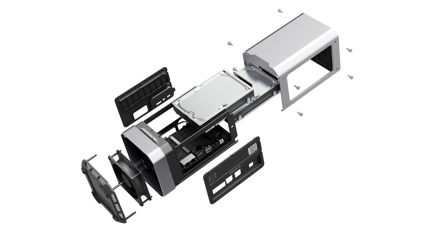

  • Dual SATA III 6.0 Gbps data connectors for 3.5”/2.5″ SATA hard disk drives with enough space inside the enclosure to store them both
  • M.2 B-Key/ M-Key/ E-Key for expandability such as SSD, 4G/5G modules, WiFi 6
  • Quiet cooling fan with a large VC heat sink for excellent heat dissipation
  • Easy to install, upgrade and maintain with ease of access to the internal components after opening the enclosure
