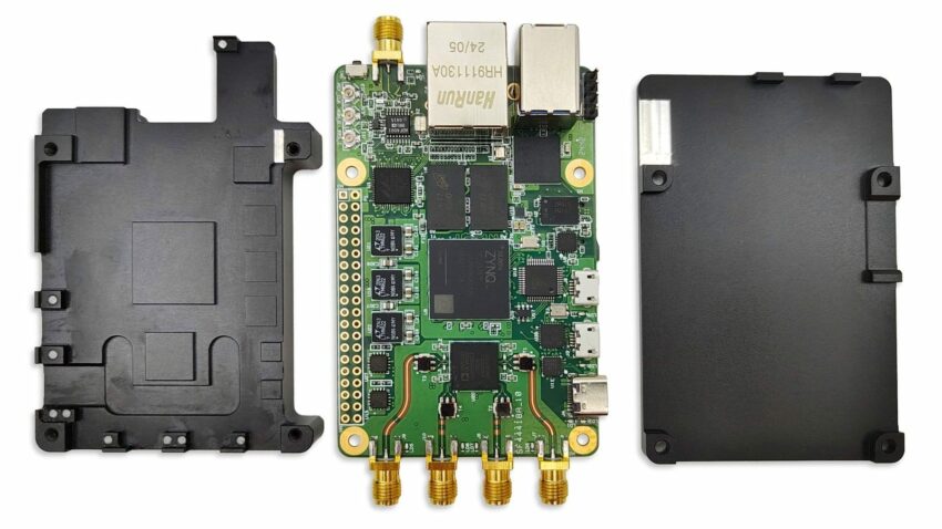

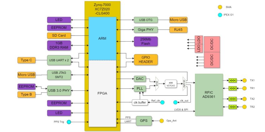

The SignalSDR Pro is a compact software-defined radio (SDR) platform designed for signal processing, spectrum analysis, and advanced communication systems. It is based on the Analog Devices AD9361 RF transceiver and the AMD Zynq 7020 SoC, providing a versatile solution for a range of SDR applications. Its small form factor matches the size of a Raspberry Pi, making it suitable for embedded or portable setups.
This device supports a tuning range of 70 MHz to 6 GHz with a 12-bit sampling rate and an RF bandwidth of up to 61.44 MHz. It includes two full-duplex TX/RX channels, accessible through four I-PEX antenna connectors. The 40-pin GPIO header allows users to connect additional hardware for custom projects or extended functionality.
The SignalSDR Pro is compatible with popular SDR platforms like ADALM-PLUTO and USRP B210, ensuring seamless integration into existing workflows. Its technical specifications and compatibility make it an efficient tool for SDR research and development.

  • SoC: AMD Zynq 7020 SoC FPGA
    • Dual-core Arm Cortex-A9 processors
    • 85,000 logic cells
  • RF Chipset: Analog Devices AD9361
    • Frequency range: 70 MHz to 6 GHz
    • RF bandwidth: Up to 61.44 MHz
    • Sampling rate: Up to 61.44 MHz
    • Resolution: 12 bits
    • Transmit power: Up to 10 dBm (frequency-dependent)
    • Channels: 2 full-duplex TX and 2 full-duplex RX
    • Antenna connectors: 5x I-PEX (including 1x GPS/analog)
  • Networking: 1x Gigabit Ethernet RJ45 port
  • USB Ports:
    • 1x USB Type-C
    • 2x Micro USB Type-B (OTG)
    • 1x USB Type-B 3.0
  • Expansion: 40-pin GPIO header (unsoldered)
  • Boot Options:
    • SD card
    • Flash
    • JTAG
  • Debugging:
    • USB-TTL
    • USB-JTAG
  • GPS: GPSDO with ~1 ppm oscillator precision
  • Dimensions: Raspberry Pi Form Factor
