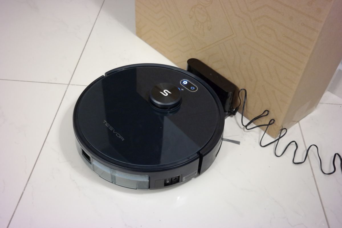

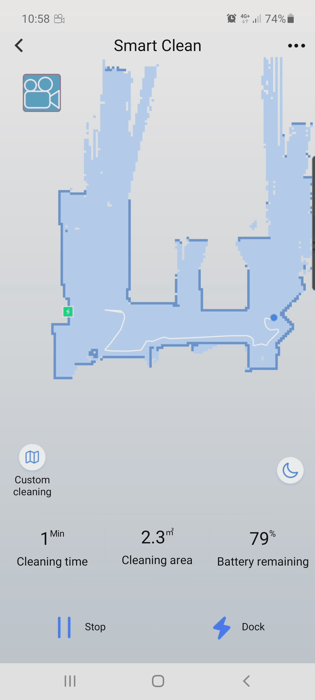

The Tesvor S6 has many sensors to help it navigate through the house. It has a front bumper sensor as well as front scanning sensors which allows it to gently bump into things as it navigates around the house. The disk on top of the vacuum is a rotating scanning laser that maps the whole house as it runs and shows a projection on the mobile app. It is able to detect small protrusions and even where a door is open or closed. The map it creates is updated every time the vacuum is run which makes the map more and more detailed and accurate the longer the robot is running. This means that you need to give the robot some time to adapt to your environment and get to know it.
On the underside of the vacuum, there are two side sensors, which monitor the surface the vacuum is operating on. These sensors also detect if the robot is near a staircase and in danger to drop off. The charging points, match up to the charging dock while charging. If the robot doesn’t sense that both points are in contact with the dock, it will retry to dock correctly. In real-life experience, we found that sometimes it gets hard to dock itself on the charging station and needs several re-tries, even if it’s very close to the base. So you will need to allow some time to find its way to charge.

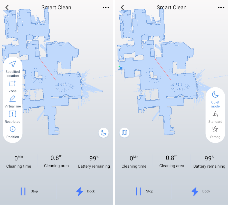

The first-time configuration of the Android app took us ~10 min to complete, as you will need to register an account and add the vacuum as a new device on the app by scanning a QR code and connecting to the Wifi of your home. Once this is done the app shows the status of the vacuum and the charge level on the screen. On our first try to command the vacuum to start cleaning there were some connection issues that we couldn’t overcome. So we waited to see if this resolves. It seems it often loses the wifi connection with the router even if we used a WiFi repeater in the center of the house. In order to get it to connect, you have to turn it off while it’s on the charging dock, then pull it off of it so the vacuum no longer charging. After about five minutes, push it back onto the dock while still off then turn it on once the robot is charging again. This could be an issue, especially if you are remotely controlling the vacuum through the internet.
In order to assist the robot in cleaning the app provides options to send the robot to a specified location, set a zone to clean, create a virtual line, indicate restricted zones, and locate where the robot position is. All these indicate you will need some time to spend to get familiarize with the device even if it considered a smart one. Also, we didn’t find a way to change the voice language of the vacuum to English as it seems it’s in German by default.
