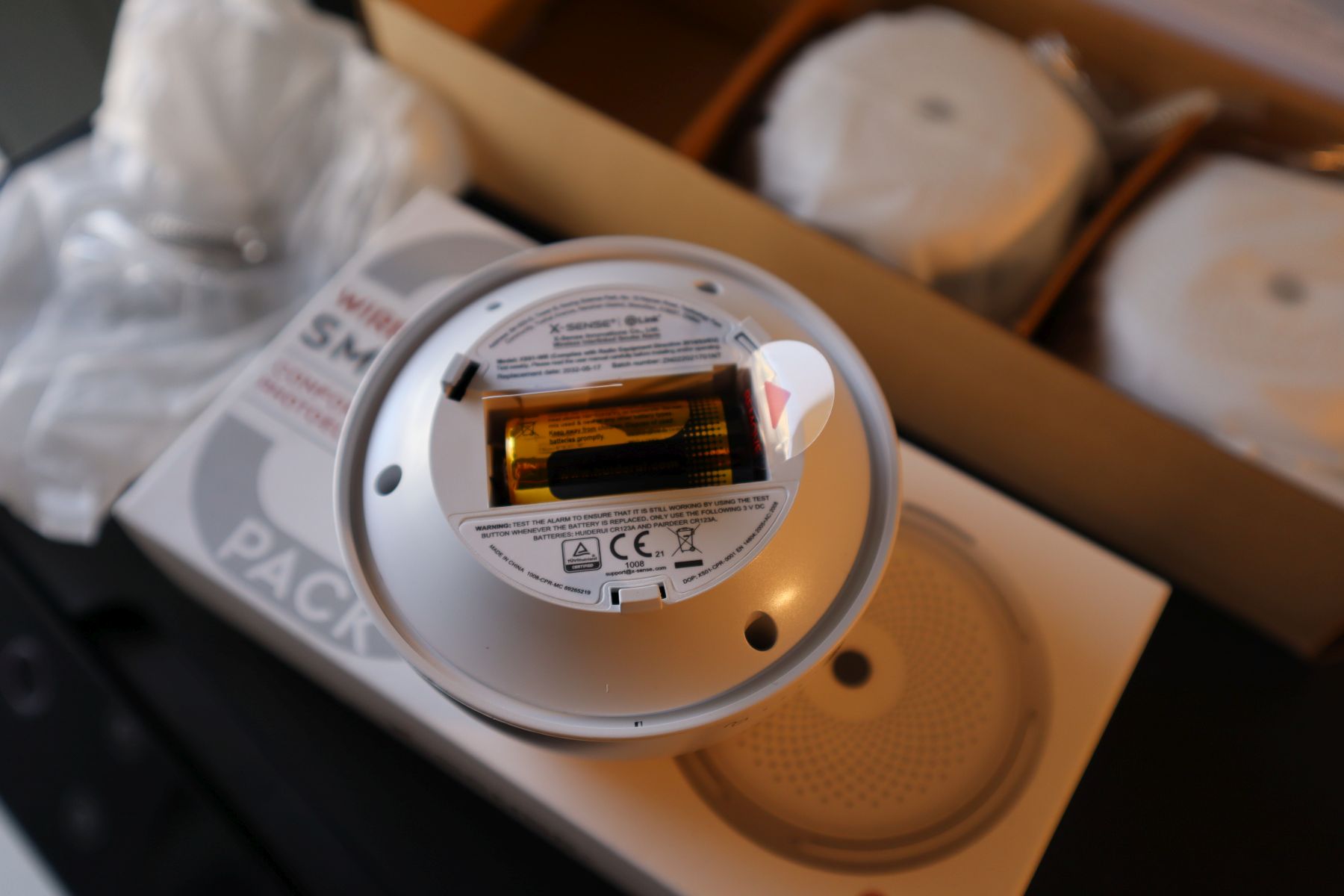

  • Battery: Replaceable 3V CR123A lithium battery
    • Operating life: 10 years
    • Battery life: 5 years

  • Battery life: The smoke detector has a battery life of 5 years while the device lifespan is of 10 years. The hardware will alert when the battery is low and there is a need to replace the battery to ensure continuous monitoring.

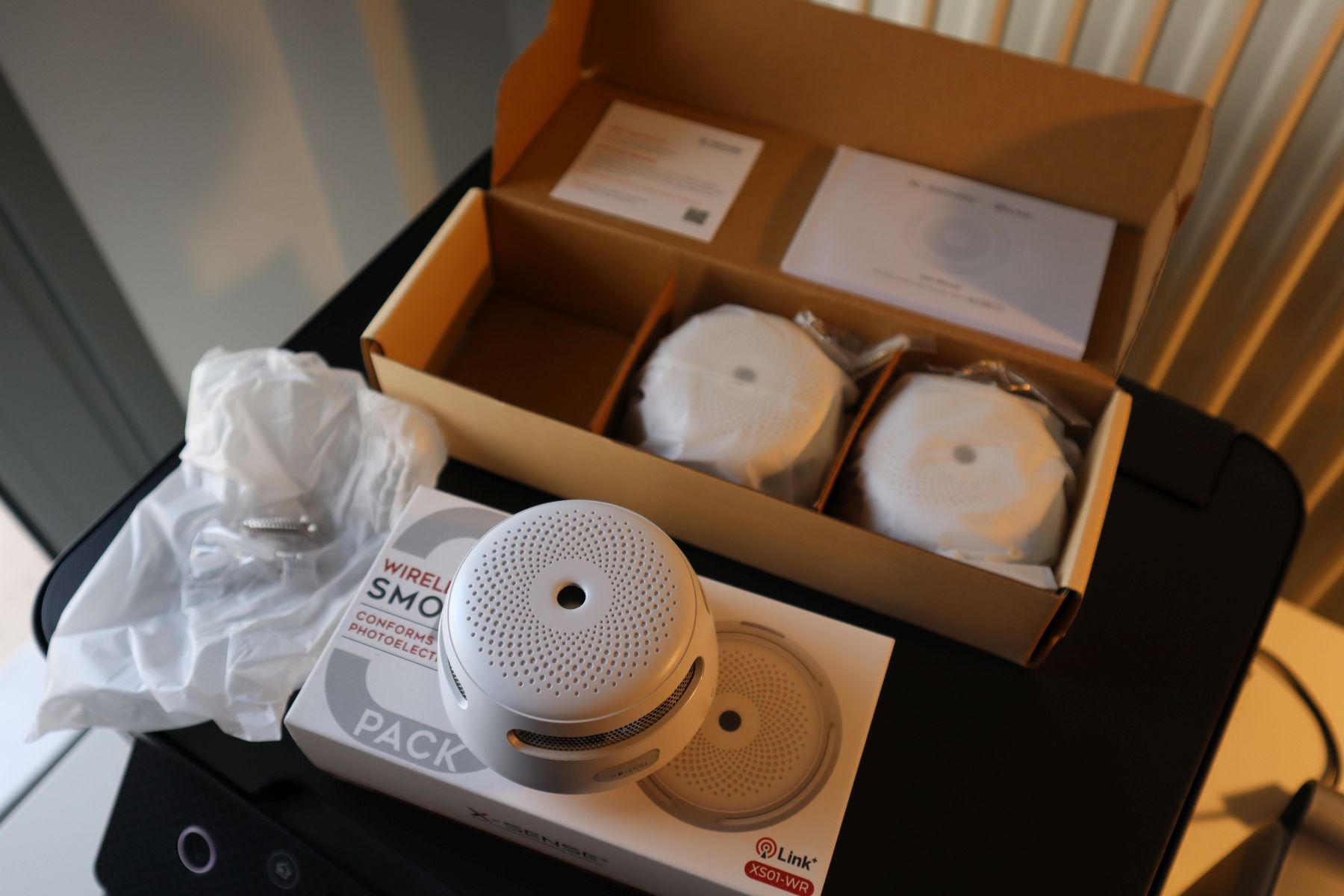

Package content:
  • 3 x alarm units
  • 3 x mounting brackets
  • 2 x screws
  • 2 x anchor plugs
  • 1 x user manual
