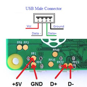

With minimal soldering, he converted the Zero’s onboard female USB jacks into a male USB plug.
You only need:
  • male usb connector
  • 4 wires
  • some soldering skills
wireing
Then you can follow the diagram to connect the male connector to Zero Pi
