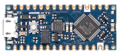

Arduino Nano Every
Arduino Nano Every goes for $9.90 or $11.90, with a 20MHz Microchip ATMega4809 AVR with 48KB flash, 6KB SRAM; USB-to-serial via Microchip SAMD11D14A (Cortex-M0+)

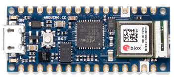

Arduino Nano 33 IoT
Arduino Nano 33 IoT goes for $18 or $20, with 48MHz SAMD21G18A (32-bit Cortex-M0+), 256KB flash, 32KB SRAM, U-blox NINA W102 (ESP32) WiFi/BT module, Microchip ATECC608A crypto chip and 6-axis IMU.
