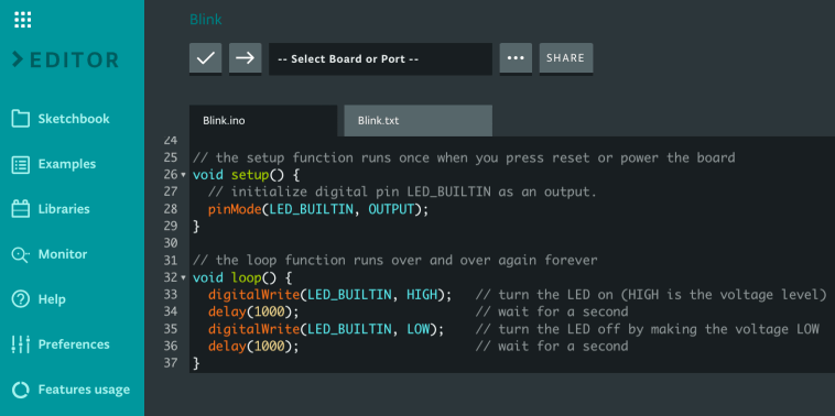

The Arduino Pro IDE is part of Arduino’s plan to provide users with tool options for use in project development. While the Pro IDE is a product still in development, the Alpha binary was released by Arduino during the announcement to allow interested users to get their hands on it and provide feedback. The initial release plan included features like;
  1. A Dual Mode – The Dual mode allows users to switch between the  Classic Arduino look and Pro’s File System view which only reveals advanced features when you need them
  2. Modern fully-featured development environment – The New Pro IDE comes with a Modern look, multi-panel IDE with an integrated file system view which makes developing large, multi-file, repository-based projects easy.
  3. Debugger – The debugger is one of the major demands of professional firmware developers and it’s one of the features scheduled to be implemented in future versions of the IDE.  Some of the debugger features highlighted for the IDE include the ability to; Set breakpoints, view trace, step through execution and debug applications without the use of the serial monitor and the timing issues it brings.
  4. Support for Additional Languages – While the embedded world still regards C and C++ as official languages, it is impossible to ignore the growing influence around the use of other programming languages like Python. Obviously seeing a future where this will be mainstream, the New Pro IDE is being designed with the ability to support other programming languages
  5. Support for third-party plug-ins and board – The Classic Arduino IDE made life easier for a lot of users with the Arduino Library and Board managers, which made it easier to install Board definitions and several third-party libraries. The Arduino Pro IDE will also support these in several ways in a cleaner more modern environment
  6. Basic Code Intellisense – Yes, we will finally be getting some code auto-complete features in the Pro IDE. While Arduino claims these features may be limited to ARM boards, here is hoping it’s usable across board.
  7. Git Integration – Version control is not negotiable for the type of large projects the Pro IDE is being created to serve.
  8. Dark Mode – For certain users, the Darkmode isn’t just to ease off the pressure on the eye, it’s a geek statement, but either way, taking the light out will definitely make long term development easier for users.
