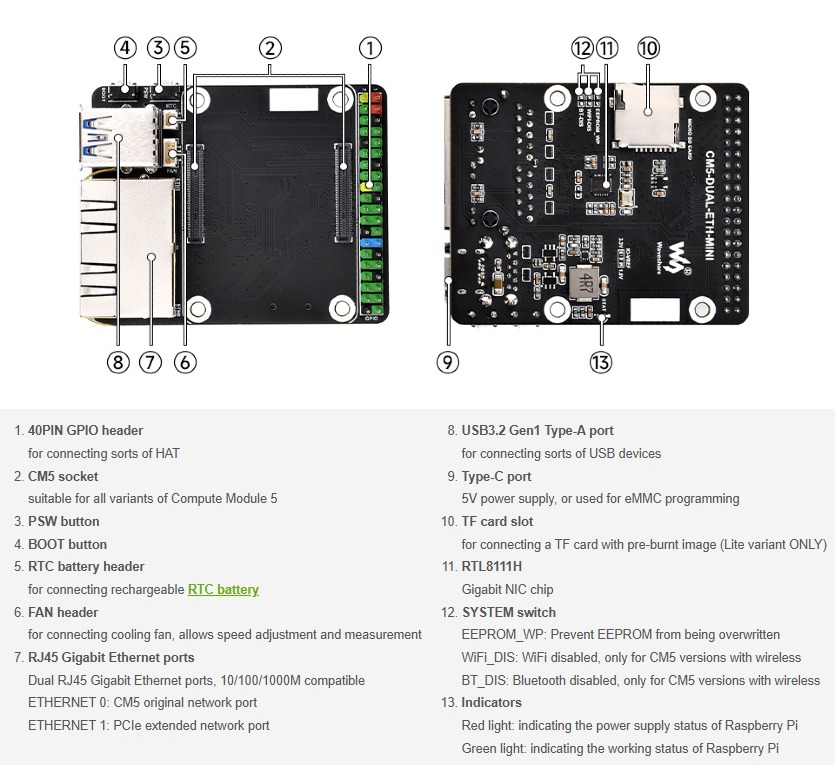

The Waveshare CM5-DUAL-ETH-MINI is a compact carrier board built for the Raspberry Pi Compute Module 5 (CM5), designed for networking and embedded applications. It features two independent Gigabit Ethernet ports based on the Realtek RTL8111H controller, making it suitable for use in routers, firewalls, IoT gateways, and edge computing systems.

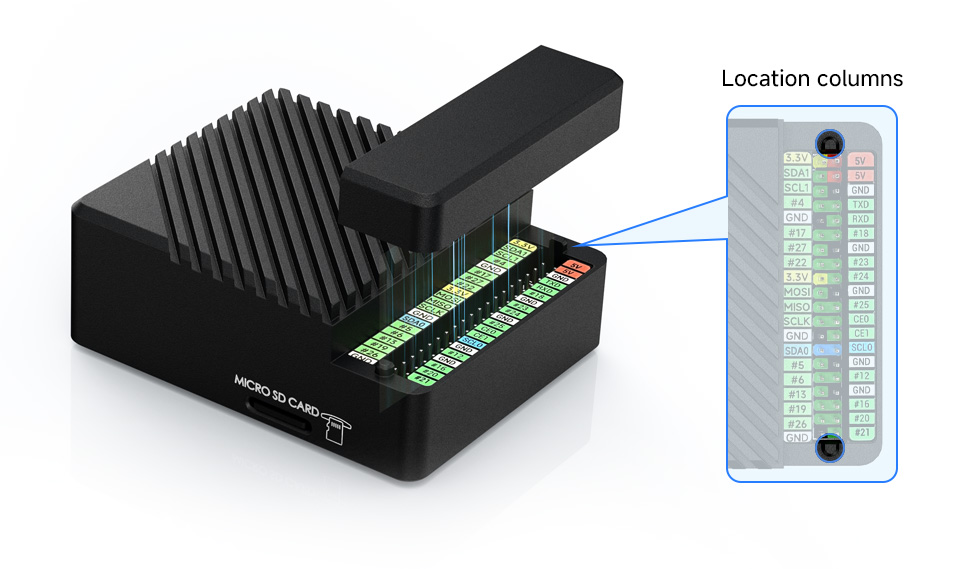

The board includes a USB 3.0 Type-A host port for high-speed peripherals, along with a USB Type-C port used for power input or eMMC programming. It also provides a standard 40-pin GPIO header for Raspberry Pi HAT compatibility and general-purpose I/O expansion. Multiple power input options are supported, including a 4-pin terminal block, as well as a dedicated connector for a 5V fan.
With support for CM5 modules featuring the Broadcom BCM2712 processor, LPDDR4X memory, and onboard eMMC storage, the baseboard offers reliable I/O access in a small footprint. Built-in ESD protection on key interfaces further improves its durability for industrial environments. The CM5-DUAL-ETH-MINI is suited for compact and low-power systems that require dual Ethernet and standard Raspberry Pi I/O.

  • Compute Module support:
  • Networking:
    • 2x Gigabit Ethernet RJ45 ports
      • 1x native GbE (via CM5 board-to-board connector)
      • 1x GbE via Realtek RTL8111H PCIe controller
    • WiFi 5 and Bluetooth 5 (only on CM5 wireless variants) with external antenna support (antenna not included)
  • USB:
    • 1x USB 3.2 Gen1 Type-A port
    • 1x USB Type-C port (for 5V power input or eMMC programming)
  • Storage: 1x MicroSD card slot (for CM5 Lite or alternate use)
  • Expansion: 40-pin Raspberry Pi-compatible GPIO header
  • Misc:

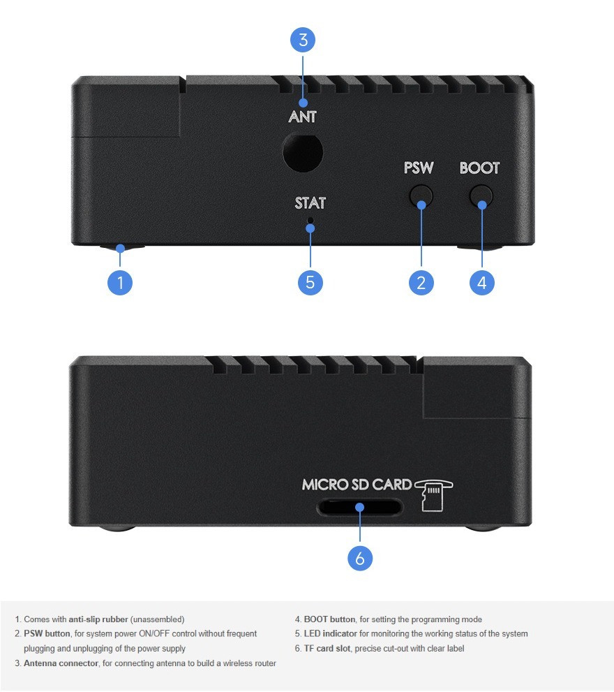

    • Power (PSW) button
    • Boot button
    • SYSTEM switch
    • EEPROM_WP switch – write protection for EEPROM
    • WiFi_DIS switch – disables Wi-Fi (CM5 wireless variants only)
    • BT_DIS switch – disables Bluetooth (CM5 wireless variants only)
    • RTC battery connector
    • 5V fan connector (disabled when used with a metal case)
    • Power and status indicator LEDs
  • Power supply: 5V input via USB Type-C port

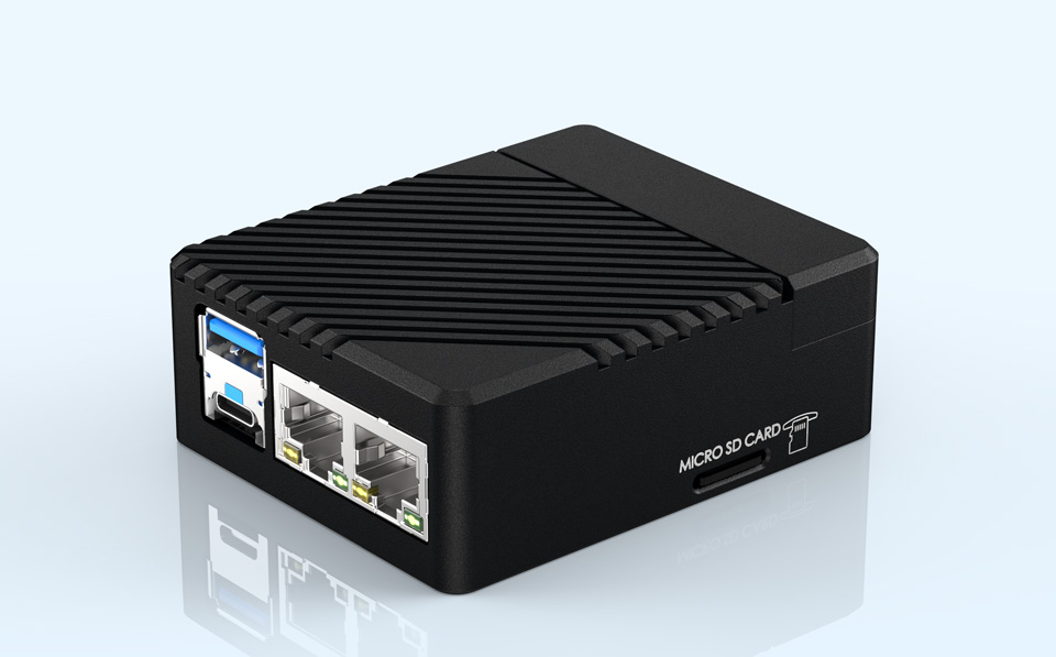

Waveshare’s CM5-DUAL-ETH-MINI is a compact dual-Gigabit Ethernet carrier board designed for the Raspberry Pi Compute Module 5 (CM5), targeting embedded, industrial, and networking applications such as routers, gateways, and firewalls. The board is available as a standalone carrier or in a pre-assembled CM5-DUAL-ETH-MINI-BOX router variant with a metal enclosure. The package includes the baseboard with case, thermal pads, anti-slip feet, a screwdriver, and an optional 27W power adapter. Raspberry Pi OS or any other CM5-compatible operating system can be used to get started. Additional documentation and setup instructions are available on the Waveshare wiki page.
