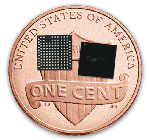

So, what is the Edge TPU? The Edge TPU is a small ASIC designed and built by Google that provides high-performance ML inferencing with a low power cost. For example, it can execute state-of-the-art mobile vision models such as MobileNet v2 at 100+ fps, in a power efficient manner. This allows you to add fast ML inferencing to your embedded AI devices in a power-efficient and privacy-preserving way. For more information on this ASIC, check out googles official documentation.

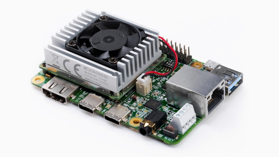

Coral Dev Board

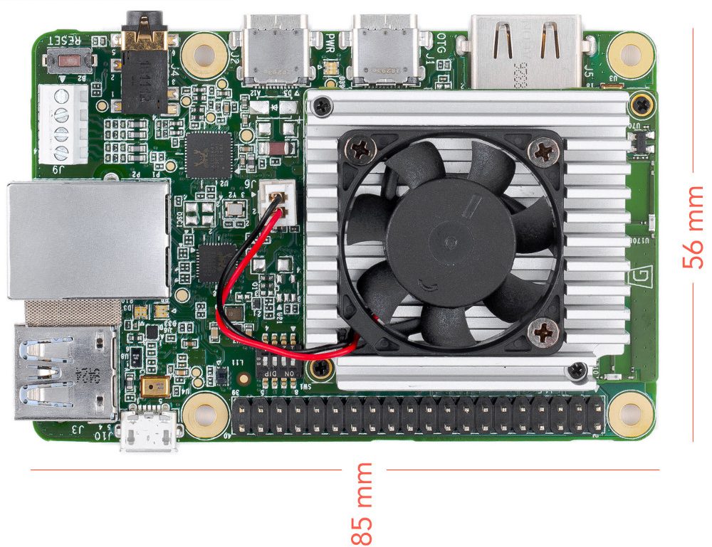

The Coral Dev Board is a single-board computer with a removable system-on-module (SOM) that contains SOC, eMMC, wireless radios, and Google’s Edge TPU. It’s perfect for IoT devices and other embedded systems that demand fast on-device ML inferencing. The board has a layout that’s somewhat similar to the Raspberry Pi. It offers a 40-pin GPIO connector just like raspberry pi. The Coral SOM connects to the baseboard with 3x 100-pin connectors. The Coral board is equipped with a microSD slot, as well as GbE, USB 3.0 host, USB Type-C OTG, USB Type-C 5V power, and micro-USB 2.0 serial console ports. Media I/O includes a full-size, 4Kp60-ready HDMI 2.0a port and 4-lane MIPI-DSI and CSI interfaces via FFC connectors. It also features a good old 3.5mm audio jack.
Google EdgeTPU ASIC
Google Edge TPU ASIC

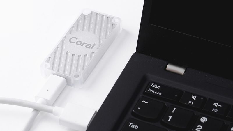

Google also unveils Coral USB Accelerator and PCIe Accelerator. The USB Accelerator is a plug-in USB stick that brings powerful ML inferencing capabilities to existing Linux systems. With the Edge TPU connected over USB 3.0 interface, it allows for quick prototyping of local AI applications. The USB accelerator can boost inference on any Linux machine, while the dev board’s array of pins and ports make it perfect for prototyping hardware and other experimental applications. The 65 x 30 mm² USB Accelerator can even work with a Raspberry Pi board, although only at USB 2.0 speeds. The stick computer is built around a 32-bit, 32MHz Cortex-M0+ chip with 16KB of flash and 2KB of RAM.
Google's Coral Accelerator
Google’s Coral USB Accelerator
The Coral USB Accelerator is a plug-in USB stick that brings powerful ML inferencing capabilities to existing Linux systems. With the Edge TPU connected over USB 3.0 interface, it allows for quick prototyping of local AI applications.

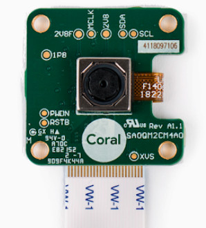

The development board is accompanied by the Coral Camera – built around a 5 megapixel (2582×1933 pixel) Omnivision OV5645 sensor. The camera is connected to the board using the CSI interface. The 25 x 25mm camera looks like below:
Google Coral Camera
Google Coral Camera

  • Dimensions: 88.1 x 59.9 x 22.38 including fan (possibly 85 x 56mm)
