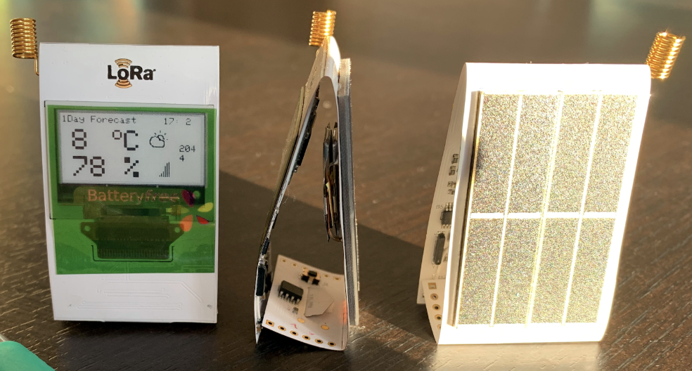

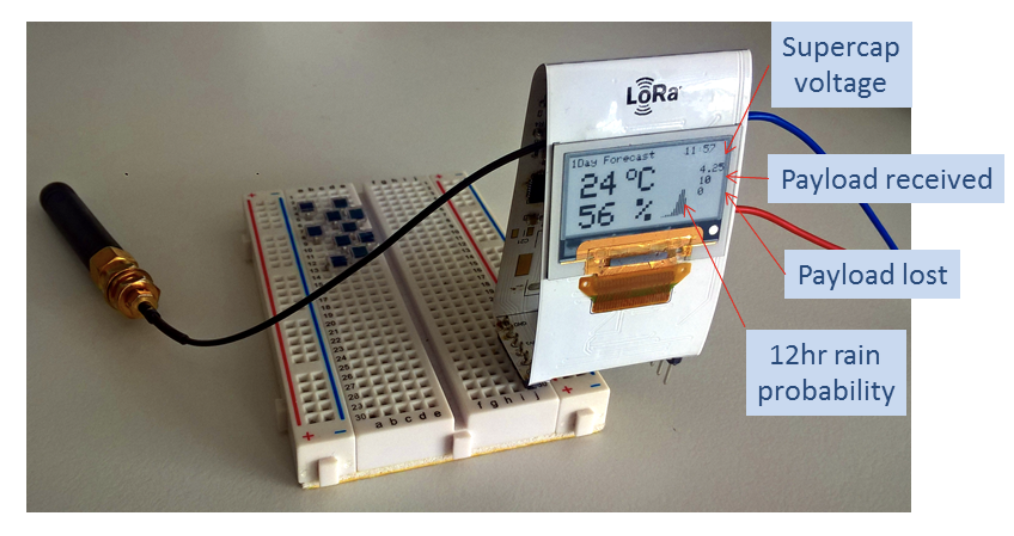

Robert Poser, passionate about ePaper displays and the famous creator of Paperino ( an easy-to-use, micro ePaper shield for the Particle & Arduino) has created LoraPaper, a LoraWan-connected ePaper display powered by only ambient light – this implies no batteries, at all, as it is entirely solar-powered through a PV cell on its back that constantly keeps an AEM10941 supercapacitor charged. Therefore, it runs autonomously when attached to the window or close to it.
LoraPaper’s display is sourced from Plastic Logic, a Hong Kong-based company that develops and manufactures truly flexible, glass-free electrophoretic displays for smart cards, mobile devices, signage, wearables e.t.c. Also, its charging is automated by an energy harvesting charge controller developed by E-peas semiconductors.
During the recently concluded The Things Conference, Robert showcased a 2.1-inch display version of the device (An upgraded version from the original 1.1-inch display) with a flexible lowlight PV cell on its backside. He noted that he is currently working on enabling support of external SPI flash for loading/saving images.
Depending on several conditions and the image content. It takes on average roughly 4mA at 3.3V for ~300ms to transition display, that is when the device connects to the web via The Things Network (TTN).
