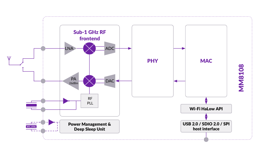

For long-range communications, the MM8108 operates on worldwide sub-1 GHz bands. This improves compatibility and usability of the SoC. There is an integrated 26 dB power amplifier and a low noise amplifier (LNA) eliminating the need for external filters during long-range communications. MM8108 also supports an external Front-End Module (FEM) enabling extended reach as required by the user. Moreover, it supports four channel bandwidths, 1, 2, 4, and 8 MHz.

MM6108 Block Diagram
