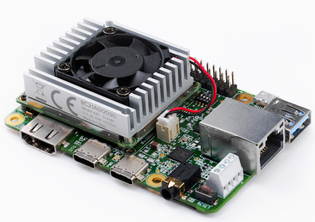

The Tinker Edge T and CR1S-CM-A boards are the products of a collaborative effort between Asus’s new AIoT business unit and the Google Coral business unit. The boards integrate the same 48 x 40mm Coral SOM module present in Google’s $150 Coral Dev Board. The SOM module runs Debian Linux on the quad-core version of NXP’s 1.5GHz Cortex-A53 i.MX8M. The Coral SOM incorporates the Edge TPU chip, which connects with the i.MX8M via PCIe and I2C/GPIO. Available also is a crypto coprocessor, 1GB LPDDR4, and 8GB eMMC. The sandwich-style Tinker Edge T and CR1S-CM-A have the 85 x 56mm dimensions as the Tinker Board S and the Coral Dev Board. The Tinker Edge T is built for AI-powered projects like cameras, game emulators and smart home devices, while the CR1S-CM-A is aimed at AI solutions for business intelligence, signage, and security applications.
Asus Tinker Edge T
The Tinker Edge T is presumably open-spec, at least for the carrier board. The Tinker Edge T is fitted with 1GB LPDDR4, 8GB eMMC, a GbE port, and 802.11ac with BT 4.1. 2x USB 3.0 ports and a USB Type-C port are available without the DP support. There are also dual MIPI-CSI2 camera interfaces with support for stereoscopic applications. An HDMI port, a MIPI-DSI interface, and a 40-pin header with Raspberry Pi compatibility is available.

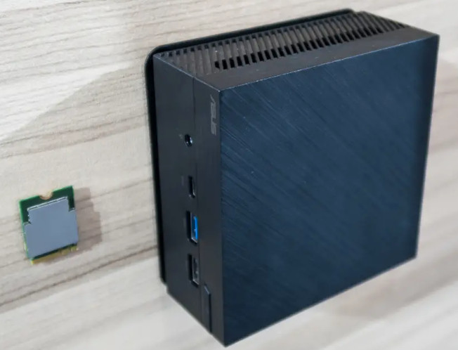

The 115 x 115mm PN60T mini-PC has several Intel 8th Gen Kaby Lake Refresh chips and includes a 1.8GHz/4GHz, quad-core, octa-threaded Core i7-8550U, a dual-core, quad-threaded 2.2GHz/3.4GHz Core i3-8130U, and a 1.8GHz, dual-core Celeron 3867U. The system integrates the Edge TPU via Google’s PCIE-E Accelerator card. The PN60T is also equipped with dual-channel DDR4 up to 32GB and features a SATA SSD and an M.2 slot. No Likely OS support includes Linux and/or Windows. No pricing or availability information is available for the Tinker Edge R, Tinker Edge T, or CR1S-CM-A SBCs. The PN60T is expected in 4Q 2019.
