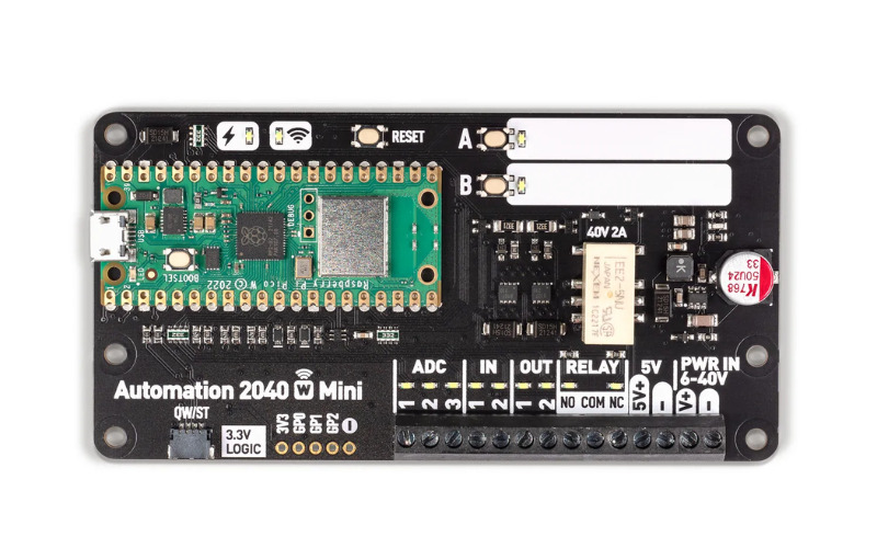

A UK-based embedded device manufacturer and supplier, Pimoroni Ltd., has launched an industrial and automation controller that can support 2.4GHz of wireless connectivity– Pimoroni Automation 2040 W Mini. The company has previously worked on a carrier board that could fit the Raspberry Pi Pico W development board, Pimoroni Inventor 2040 W.
A UK-based embedded device manufacturer and supplier, Pimoroni Ltd., has launched an industrial and automation controller that can support 2.4GHz of wireless connectivity– Pimoroni Automation 2040 W Mini. The company has previously worked on a carrier board that could fit the Raspberry Pi Pico W development board, Pimoroni Inventor 2040 W. This time the Automation 2040 W Mini is taking a step forward to be able to hold the all-new Raspberry Pi Pico W.
Pimoroni has provided the hardware platform with many analog channels, powered outputs, buffered inputs, and a relay for industrial applications inside the automation controller. To control pumps, fans, solenoids, chunky motors, and electronic locks, the Pimoroni Automation 2040 W Mini is expected to serve the purpose.

  • Mainboard: Raspberry Pi Pico W
  • CPU: Dual-core Arm Cortex-M0+ running at up to 133MHz clock frequency
  • Memory: 264kB of SRAM
  • Flash memory: 2MB of QSPI flash supporting XiP
  • Wireless connectivity: 2.4GHz wireless
  • ADC: 3x 12-bit ADC inputs up to 40V
  • Digital inputs: 2x digital inputs up to 40V
  • Digital outputs: 2x digital sourcing outputs at V+
  • Relay: 1x relay
  • Buttons: 2x tactile buttons with LED indicators and a reset button
  • Connectors: 1x Qw/ST connector for breakout boards
  • Software: C/C++ and MicroPython libraries
  • Power supply: Compatible with 12V, 24V, and 36V systems, requires a supply of 6-40V and can provide 5V up to 0.5A for lower voltage applications

The carrier board has indicator LEDs to show what’s happening with the setup and test the program without having hardware connected. For more digital inputs, outputs, and relays, the company has provided a larger board with 4x digital inputs, 3x digital sourcing outputs, and 3x relays. Also, if the user wants to mount the board inside the switch cabinet or any other electrical enclosure, Pimoroni has provided DIN rail mounts, specifically for the carrier board.
For connecting external breakout boards, the Pimoroni Automation 2040 W Mini carrier board has Qw/ST connector that makes it easy for the user to connect up Qwiic or STEMMA QT breakouts. The developer can directly plug it in with a JST-SH to JST-SH cable.
