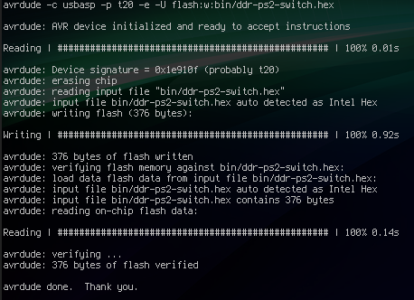

Kevin listed the following steps that are involved in programming TPI-only AVR MCUs using USBASP:
  1. Buy another USBASP programmer as one of them will be the programmer and another one would be the target that is going to become TPI capable.
  2. Download the latest firmware from Thomas Fischl’s website: https://www.fischl.de/usbasp/
  3. Switch the programming jumper on the target by shorting the appropriate header (sometimes labeled JP1, sometimes labeled JP2). It’s a two-pin jumper and is NOT the target voltage jumper, nor the “slow clock” jumper.
  4. Connect the programmer USB to the PC. Don’t connect the target to the PC.
  5. Connect the two USBASPs using the 10-pin ISP ribbon cable.
  6. Use avrdude to program the downloaded firmware (be sure to choose the correct hex file for the ATmega used on the target programmer).
For interfacing, connect the TPIDATA pin of the TPI header to the MOSI pin of MCU, TPICLK to ISP CLK, and RESET to the corresponding RESET pin. Further, it is necessary to ensure that the AVR is running at 5V.
