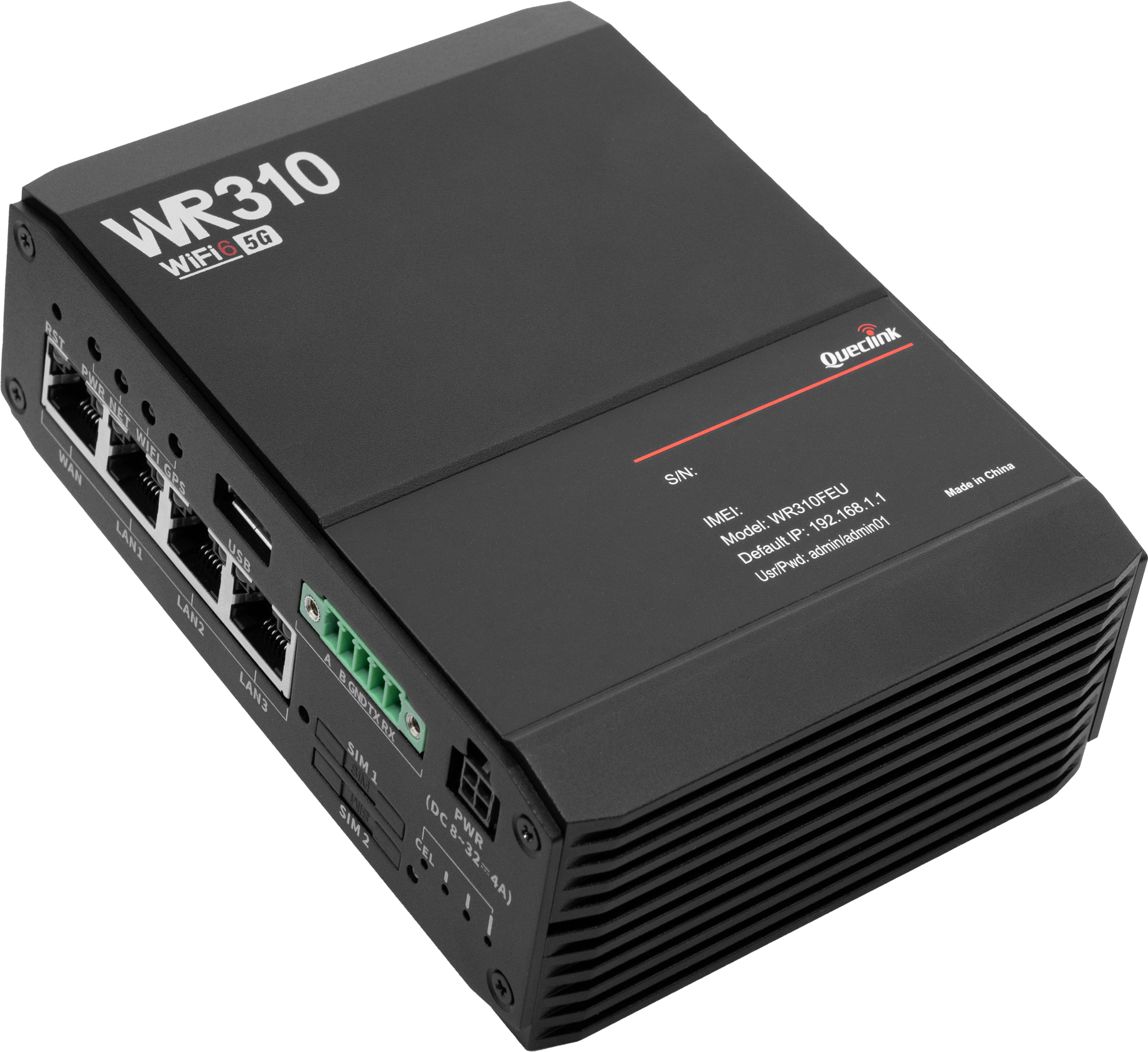

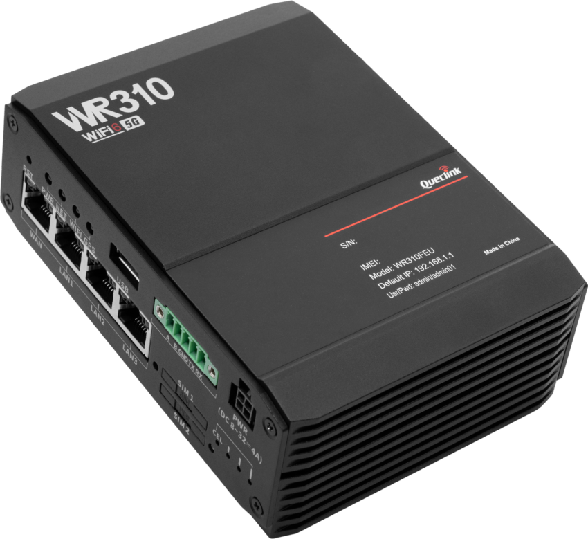

Queclink has introduced the WR310 Series, an industrial cellular router featuring 5G NSA/SA and Wi-Fi 6 connectivity for machine-to-machine (M2M) applications. The router is built on Qualcomm’s chipsets and integrates a 64-bit processor with an embedded operating system. It is designed for industrial environments requiring high-speed and stable mobile connectivity.
The WR310 Series includes four gigabit Ethernet ports, a USB Type-A port, and a terminal block supporting RS232 and RS485 interfaces. It operates within an 8 to 32V DC input range, making it suitable for industrial IoT (IIoT), smart manufacturing, and edge computing applications. The device also features GNSS positioning and Bluetooth for enhanced communication and integration.
Queclink offers three WR310 models based on regional compatibility: WR310FEU for EMEA, AP, and Brazil, WR310FAU for LATAM, and WR310FNA for North America.
WR310 industrial cellular router

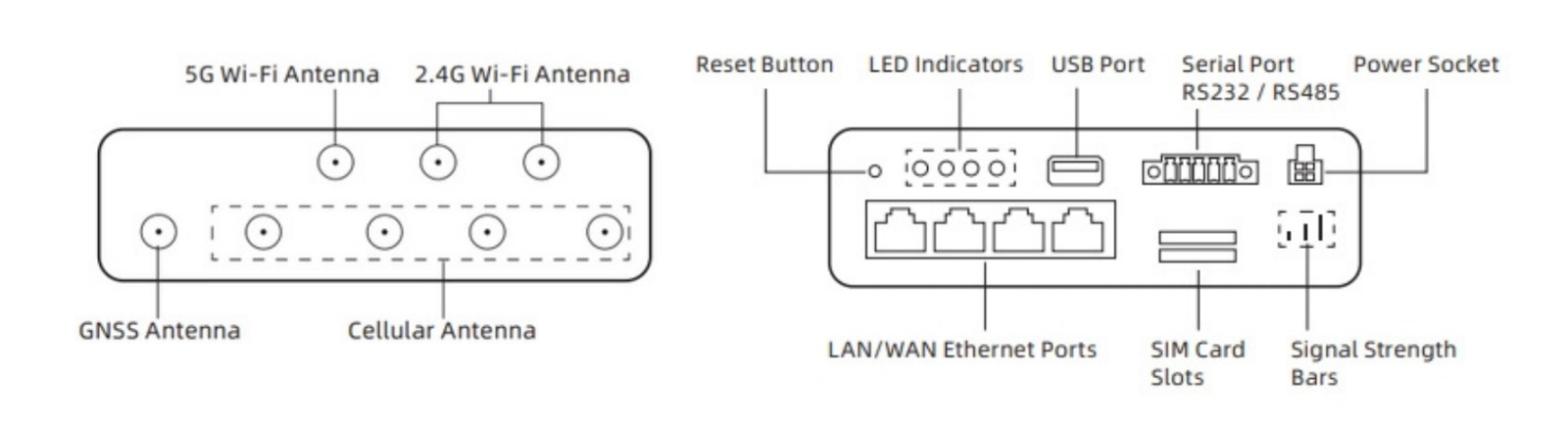

  • Antenna Interfaces:
    • 4x SMA for 5G
    • 3x RP-SMA for Wi-Fi 2.4/5GHz
    • 1x GNSS SMA antenna
  • LED Indicators: Power, Net, Wi-Fi, GNSS, mobile status, signal strength, 2x WAN, 6x LAN

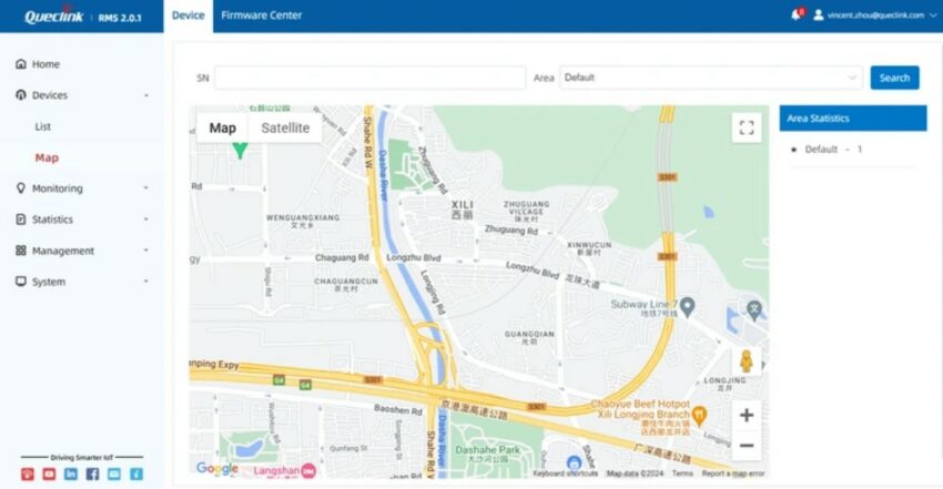

The WR310 is reported to run an OpenWrt-based Linux OS with a web-based UI for configuration and FOTA updates. For customization, the WR310 can integrate with Queclink’s Remote Management System (RMS), a centralized cloud platform that provides real-time device status monitoring, alert management, task automation, and data analytics—eliminating the need for on-site maintenance.
