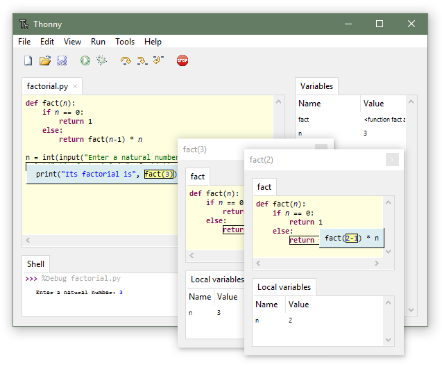

Thonny Code Editor for Wio RP2040 Mini Development board
The board is compatible with the beginner-friendly Thonny code editor, which also used by Raspberry Pi Pico. Hence, the transition of the Pi Pico projects to Pico IoT projects becomes simple to program. Discussing further, Wio RP2040 mini development board supports programming in C/C++ and MicroPython.
