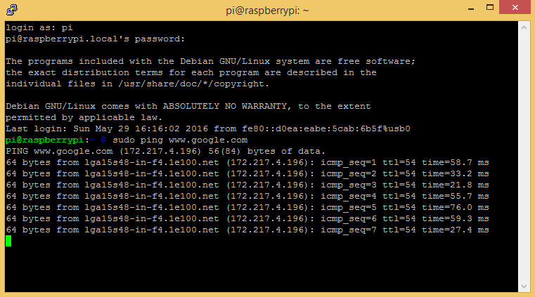

The trick used here is to recognize the Raspberry Pi Zero as a USB/Ethernet gadget, in other words using Ethernet emulation over USB.

In order to do the trick of getting the Internet access over USB you need to setup up Pi Zero OTG before connecting Pi Zero with USB.
When you connect it with USB, after setting up the OTG, you will see the PI Zero under “Other devices”->“RNDIS/Ethernet Gadget” from device manager.
The last step is to set up shared Internet access with your USB/Ethernet gadget, here it’s Pi Zero, from “Network Connections”.
Communication with Pi Zero is done by using PuTTY.
ping www.google.com
ping www.google.com On Pi Zero
