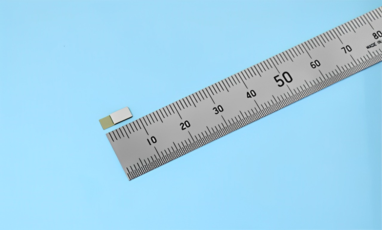

Quantum computers one day should be able to solve certain computing problems much faster than a classical computer. One of the most promising approaches is based on the utilization of single photons to carry and process quantum information. Scientists of the University of Stuttgart and the Karlsruhe Institute of Technology (KIT) were now able to integrate three necessary main components (single-photon source, beamsplitters and single-photon detectors) on a single chip and operate it on the single-photon level. This experiment demonstrates the functionality of the basic components for a scalable system for photon-based quantum information processes.  The results got published in Nano Letters.
Photonic circuit in which single photons are emitted, guided and split into two waveguide-arms. The detection is done on-chip via integrated detectors at the end of the two waveguides arms, the reflecting metal layers help to suppress stray light coming from the excitation laser.
