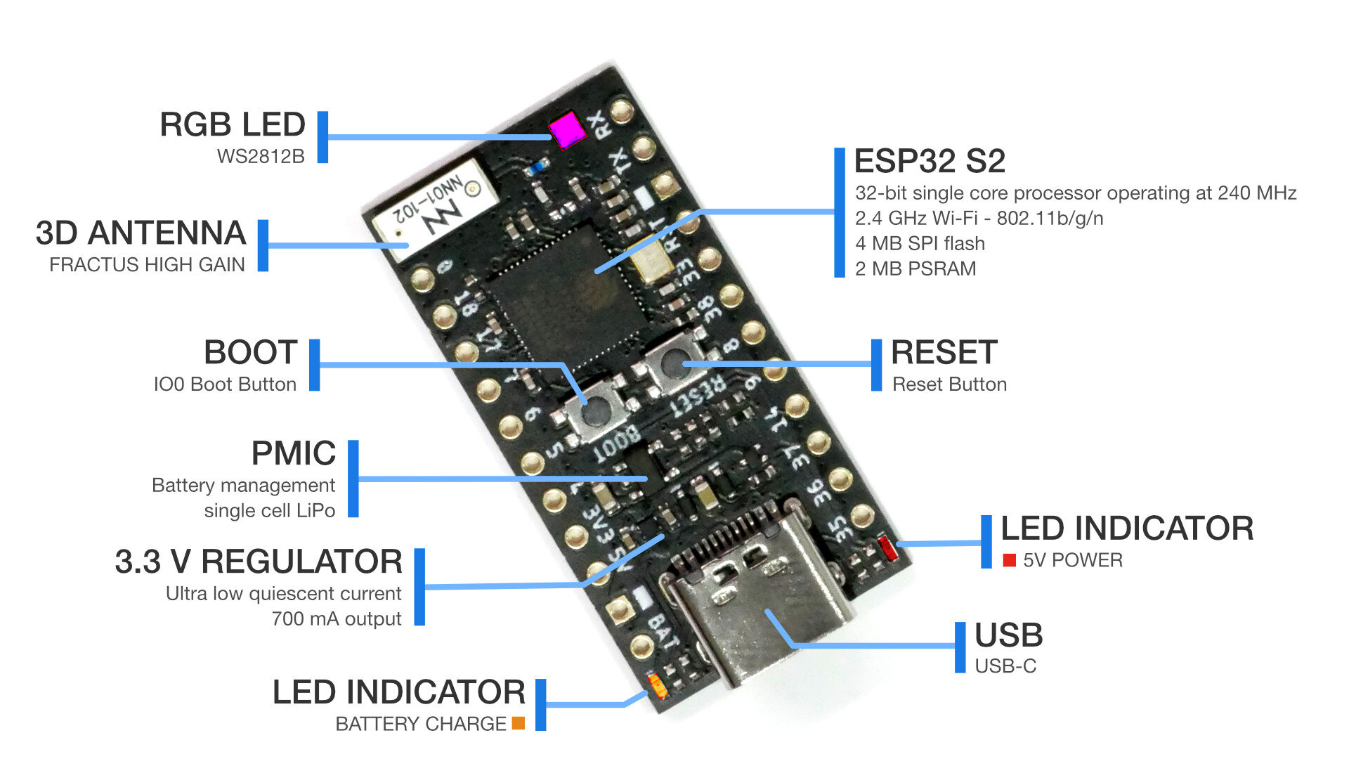

TinyS2 development board comes with popular ESP32-S2 SoC, so it is capable of a wide range of use cases. The compact form factor with a powerful core makes it a special development board. As it comes with Espressif Systems’ SoC thus it has good compatibility with the software support. Discussing further, the board has ESP-IDF and Arduino support for C++ programmers. It also has CircuitPython support for coding the use case with the TinyS2 development board.
We also saw the TinyPICO ESP32 development board for giving access to the power of the ESP32’s dual-core 240 MHz and internet connectivity. So similarly the TinyS2 also has a LiPo battery charging feature locally on the board. The 4MBs of flash and an on-board RGB LED that can be shut down to reduce deep sleep current and a generous 700mA output 3.3V regulator are also some similar functionalities with TinyPICO.
TinyS2 development board comes with a wide range of interfacing options. This includes SPI, I2C, UART, ADC, DAC, 5V, 3.3V, and BAT signals. Additionally, it has booting and reset buttons, a battery charging status LED, and power LED. The compact dimensions of the board are 41 x 17.8 mm.

  • ESP32-S2 SoC working at a frequency up to 240 MHz
  • Board has a USB Type-C port for power supply and programming purposes
  • It comes with an interfacing option of 4MP SPI flash and also features 2MP PSRAM
  • Wireless connectivity with 2.4 GHz WiFi 4 plus 3D antenna technology
  • The power rating of 5V DC supply through USB-C port
  • Lipo battery management for optimizing power consumption
  • 700 mA 3.3 V LDO regulator for linear regulation of the output voltage
  • VBAT and 5V Sense pins along with the 17x GPIOs
