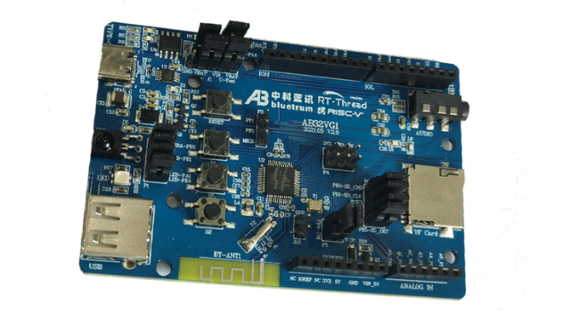

AB32VG1 Development Board Front View

  • CPU: Bluetrum AB5301A RISC-V MCU clocked up to 120 MHz
  • Flash memory: 1MB flash with TF card slot
  • Wireless Connectivity: Bluetooth 5.0, BLE and FM radio
  • Expansion Headers: 1x I2C, 6x ADC, 6x PWM
  • Power Supply: 5V via USB Type-C or Vin pin on the expansion header
  • Dimension: 9cm×6cm
According to the datasheet available in English, the CPU is integrated with 32-bit RISC-V MCU that can be over-clocked up to 192 MHz with 192KB RAM and 1MB flash storage. As we have all used Arduino UNO, the AB32VG1 development board comes in the same form factor as Arduino UNO but a RISC-V MCU at its heart. This gives tough competition to the most popular ARM-based development board. The board comes with similar GPIO headers that give access to an I2C, six ADC, and six PWM connections.

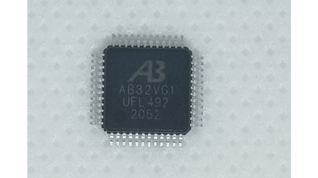

AB32VG1 Development Board SOC
When it comes to wireless connectivity, the development board supports Bluetooth 5.0 and BLE specifications and is equipped with an FM radio. The board also features a TF card for extra storage required as per the requirements of the user. To power the board, you can use 5V via USB Type-C or Vin pin on the expansion header. This is open-source hardware with all the schematics and BOM available on Gitee where the users can take a look. However, it is important to note that the microcontroller is an in-house tape out and there is no detailed information regarding it.
