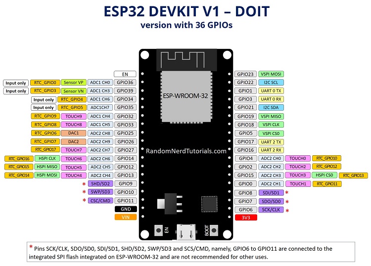

Features of ESP32
ESP32 is a series of low-cost, low-power system-on-chip microcontrollers with integrated Wi-Fi and dual-mode Bluetooth. It shares many functionalities with the Arduino and can be programmed with the Arduino IDE. ESP32 is basically an easy upgrade path to wireless communications for seasoned Arduino users.
The ESP32 supports many peripherals such as capacitive touch, ADC, DAC, I2C, SPI, UART, I2S, PWM. It is appropriate for IoT Projects and enables Bluetooth communications for Smartphone applications.
ESP32
The ESP32 peripherals include 10 Capacitive sensing GPIOs. They can detect variations in any medium carrying an electric charge. Hence, these capture the variation induced when touching the GPIOs with a finger. You can remove the need for mechanical buttons by integrating these pins into capacitive pads to provide touchscreen functionality.
You can generate variable PWM signals by configuring the 16 channels provided by the ESP32 LED PWM controller. To set a PWM signal, signal frequency, duty cycle, PWM channel, and PWM output GPIOs must be configured in the code. Also, ESP32 has 18 Analog-to-Digital Converter (ADC) channels, 3 SPI interfaces, 3 UART interfaces, 2 I2C interfaces, 2 Digital-to-Analog Converters (DAC), and 2 I2S interfaces.
The ESP32 also features a built-in hall effect sensor that detects changes in the magnetic field in its surroundings.
