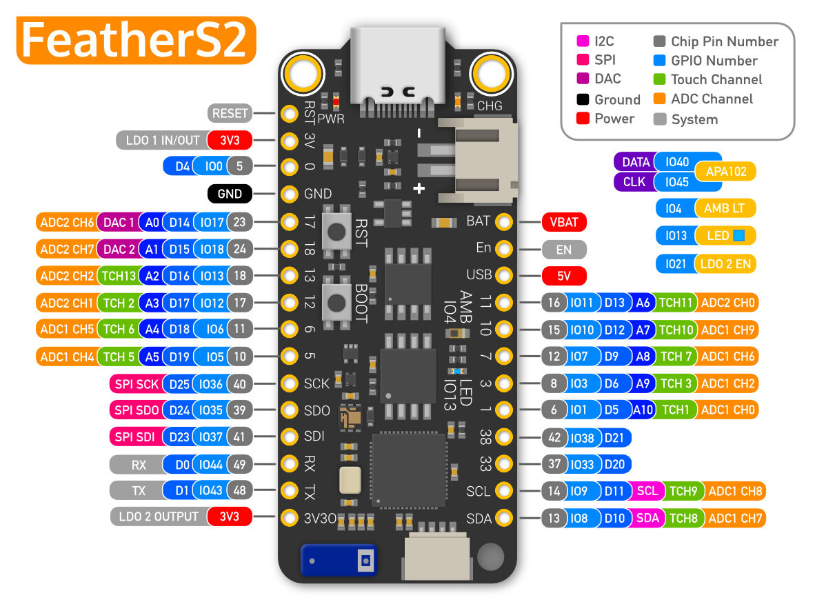

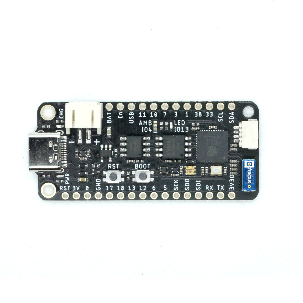

The FeatherS2 development board by Unexpected Maker offers an easy platform for makers to develop, play, and build IoT devices. The board comes with an interesting layout that comprises of Espressif ESP32-S2 WiFi SoC, 16 MB of Flash memory (for firmware and file storage), 8 MB of QSPI-based external PSRAM, several I/O and a typical USB Type – C port for power and programming.
Measuring 5.1cm by 2.3 cm, the FeatherS2 comes at a fair size for the features it has. Some of such features and specifications include:
  • Espressif Systems’ ESP32-S2 single-core Tensilica LX7 processor running @ 240 MHz with RISC-V ultra-low power co-processor
  • 320kB SRAM
  • 128 kB ROM
  • 8MB PSRAM
  • 16MB SPI Flash
  • 2.4 GHz 802.11b/g/n Wi-Fi with integrated 3D antenna
  • 1x USB Type – C port for power and programming
  • Up to 21x GPIOs
  • RGB LEDs, Charging  / Power LEDs and User LEDs
  • QWIIC / STEMMA connector
  • ALS-PT19 Ambient Light Sensor
  • 5V via USB-C port
  • 2x 700 mA 3.3 V LDO regulator
  • 2-pin battery connector
  • LiPo battery management, and,
  • Optimised power path for low-power battery usage
  • Dimensions – Approximately 5.1 cm x 2.3 cm
The developer, giving reasons why he included two LDO voltage regulators in the board has explained that:
“The first one is for the general operation of the board and the ESP32-S2, RAM and Flash. The second LDO is for you to use to connect external 3V3 modules, sensors and peripherals, and it has programmable EN control tied to GPIO21 + it’s connected to the deep sleep capabilities of the S2, so if the S2 goes into deep sleep, the 2nd LDO is automatically shut down for you!”
