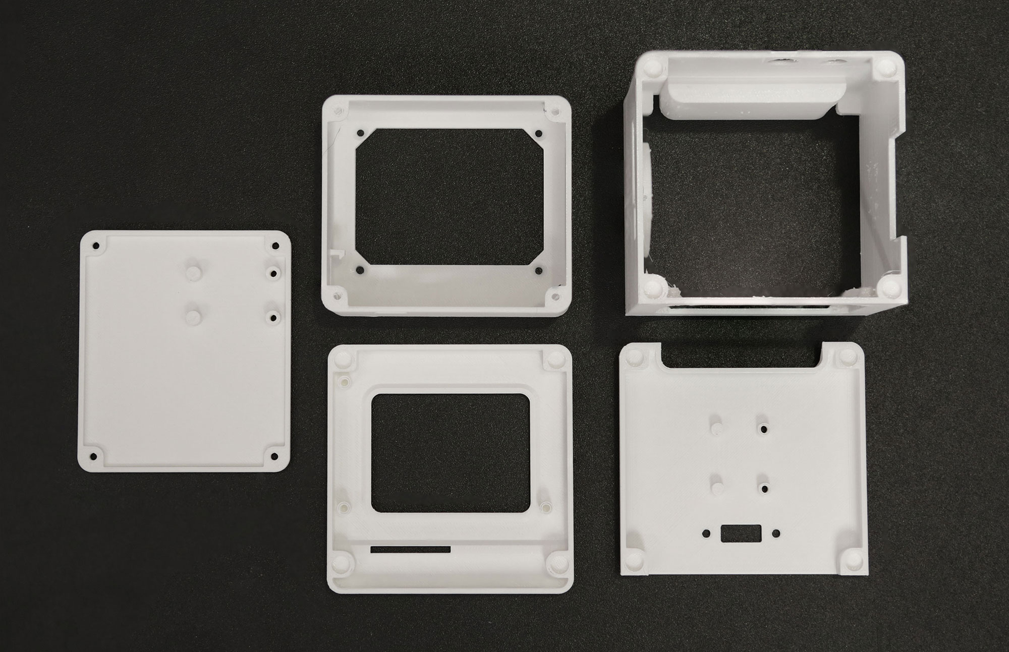

Building Mac Pi with 3D Printing
3D Printed Parts
The outside casing is entirely made of 3D printed materials and separated into five parts. This five parts enclosure is optimal for desktop 3D printing using ABS/PLA filament. But PLA material is preferred because ABS prints tend to warp with surfaces that feature fillets and chamfers. According to the Ruiz brothers, you have the option of having the components printed by a service or printing them yourself with an FDM 3D Printer. The open-source design is free to download and available to customize using CAD software. If you are working on 3D printing for the first time, then refer to this documentation.
