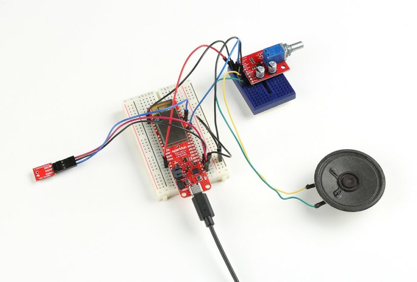

SparkFun AzureWave Thing Plus AW-CU488 Application
According to the manufacturer, the board has two processing cores, a low-power Real-M200 Cortex-M23 core, and a high-performance Real-M300 Arm Cortex-M33 core. There are 30 general-purpose input/output (GPIO) pins available, which is significantly more than on a typical Thing Plus or Feather board. Seven of these are connected to 12-bit analog to digital converters, 11 support pulse-width modulation, and two UART, two SPI, and one I2C bus. Furthermore, the module comes with 512kB of SRAM, 4MB of PSRAM, and 4MB of SPI flash. A built-in audio CODEC with two-channel analog inputs and outputs and a sampling rate of up to 176.4 kHz is an additional feature of the board.
The board includes a two-pin JST connector and the MCP73831 single-cell, lithium-polymer (LiPo) charging circuit for individuals who need to run their applications remotely. In order to make it simple for you to integrate external hardware, the manufacturer has provided the hardware development board with Qwiic connector for I2C devices.
