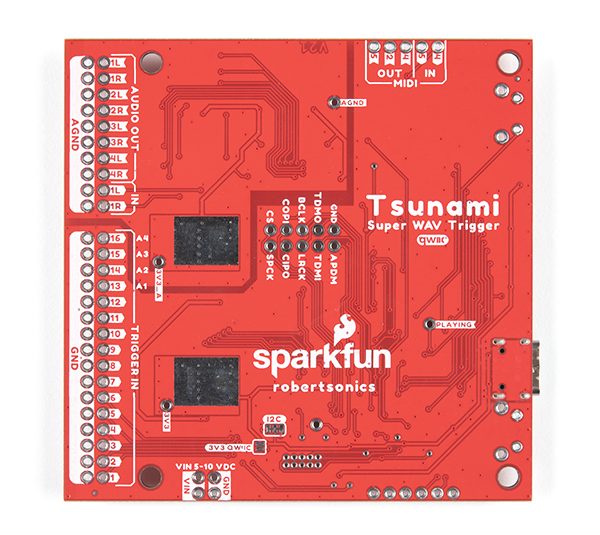

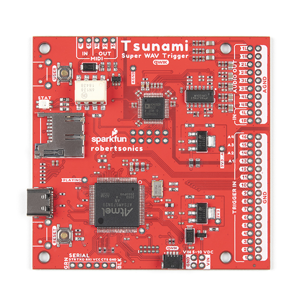

Front View Qwiic Tsunami Super WAV Trigger

Back View of Qwiic Tsunami Super WAV Trigger
