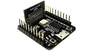

14. ESP32-C3 – a modified Espressif’s ESP32, a cost-effective, RISC-V-based MCU with Wi-Fi and Bluetooth 5 (LE) connectivity
ESP32-C3 is a single-core, 32-bit microcontroller with 400KB SRAM and a clock speed of 160MHz. Its integrated Wi-Fi is rated 2.4 GHz while its Bluetooth 5 (LE) can operate at long-range. ESP32-C3 seeks to meet the most common needs for connected devices by providing a simple and secure connectivity for IoT applications.
Features and Specifications:
  • Design: single-core, 32-bit, RISC-V-based
  • Processing Speed: 160MHz
  • Memory: 400KB of SRAM
  • Connectivity: 2.4 GHz Wi-Fi and Bluetooth 5 (LE) with a long-range support
  • Peripherals: 22 programmable GPIOs with support for ADC, SPI, UART, I2C, I2S, RMT, TWAI, and PWM.
Download the datasheet for more information configuration.
